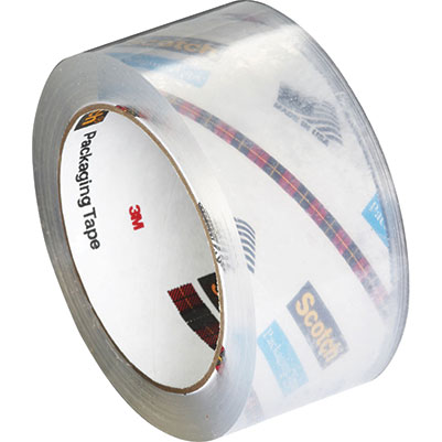

It might. I'd try it out without stabilizing goo and tape the bottle.

Tape the glass and you will greatly limit it's flying about.
