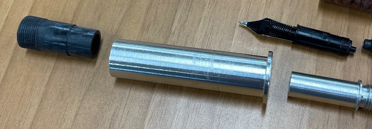

For those of you doing this, is it very careful machining of the cap liner to make that happen?
Maybe I over complicated it but I have a cap liner with a threaded insert that can be adjusted down against the section.
Too much?
Too much?
You already took it way further than I do by have a metal cap liner. I don't make many caps from wood, so they are typically a single material (such as cellulose acetate, acrylic acetate, galalith).
I drill as close as I can manage to the correct depth by hand/eye. I'm using a wood lathe, not a metal lathe, so the accuracy is limited, but there are always ways to compensate - an extra half turn on the cap threads, for example.
I read this last week about sealing against the section, I'll admit hadn't really thought about it but it makes sense.
Too much?
My approach is similar but I made a dummy cap with an extended finial. I screw the finished barrel and section in with the desired number of turns, screw the finial down to it and that tells me where the stop needs to be.
For pens where the cap overhangs the barrel, there is somewhat more tolerance as the exact position doesn't matter quite so much so long as there is sufficient clearance cut from the inside between the lip and the threads. For pens with a step between the threads and the rest of the barrel, cutting the shoulder in the cap too deeply will cause the cap to stop on the step on the barrel, whereas cutting it shallow will cause the cap to stop short and leave a gap. I use a metal lathe, so nailing the depth within a couple thousandths of an inch is pretty straightforward. I use a pair of calipers to measure from the front of the section to where I want the cap lip to sit and cut the shoulder to that depth.
