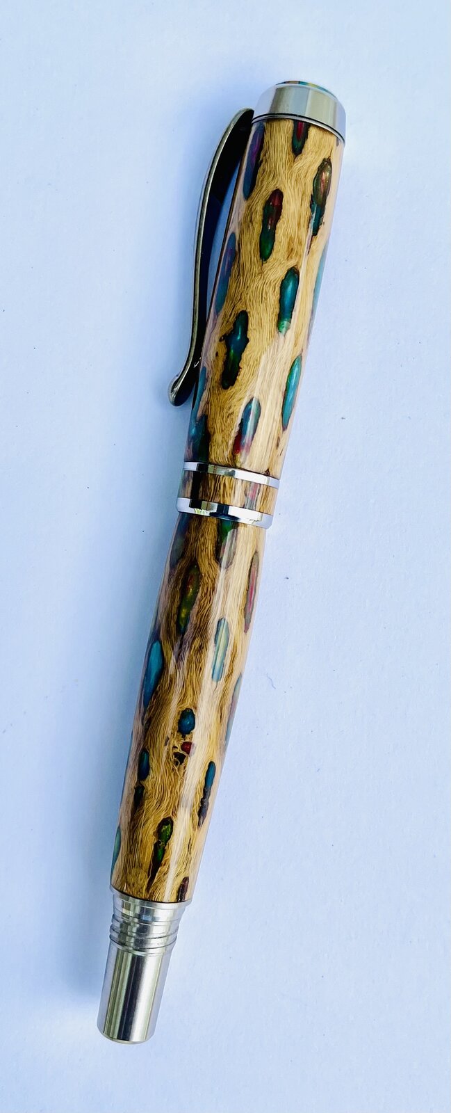

Place your cactus in the tube, be sure it's snug so it doesn't float up on you. If it's loose, wedge it or hot glue it in a small spot against the tube wall. Then alternate your resin colors, pouring down the middle hole of the cactus. Works great for me.

To add to what John suggested allow me to give you a few more tips. If you have a solid blank trim the ends so you can see the cactus center. That way you can drill in the center of the cactus and not the blank. That way you should have an even pattern around the pen. Or if you know what kit you're going to use drill the cactus and paint the tube first. I trim the cactus just proud of the tube but not to interfere with the stoppers in the mold. Slide the tube in the cactus then do a tube in cast. That way you'll have a nice pattern around the pen. No worries about floating. It's a little more prep work but less work and waste down the road. Good Luck.
