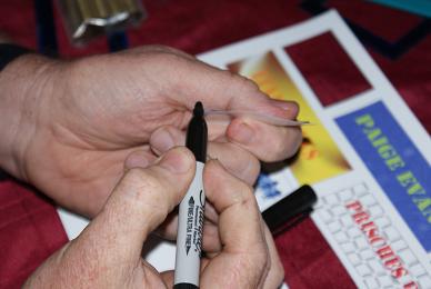

One thing you may want to do is before you put your label on is to get a pen the same colour as your label and colour the side that will be the over hang. As per pic.
David
