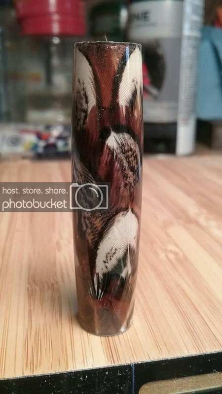

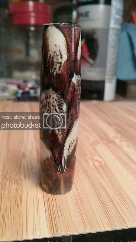

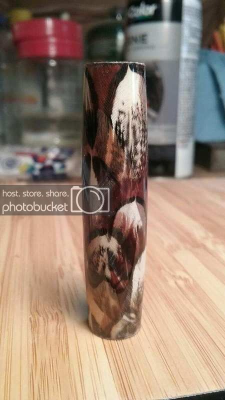

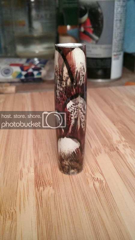

I wasn't even going to turn this down. I cast it a week ago in PR and when I pulled it from the mold all the feather tips were covered in jillions of teeny tiny bubbles. Almost frost like look to it. Mad, I tossed it to the side and didnt look at it again until this morning and 90+% of those air bubbles were gone. I missed them while taking these pics, must have just been out of view but they are there.
Is this..or can this be an example of a resin that hadn't fully cured yet? Shop temp was in the upper 60's. I used 3 drops catalist per ounce. The PR I used was Castin Craft.
I was under the impression that if there were bubbles when the resin set, they were there for good. :confused:
