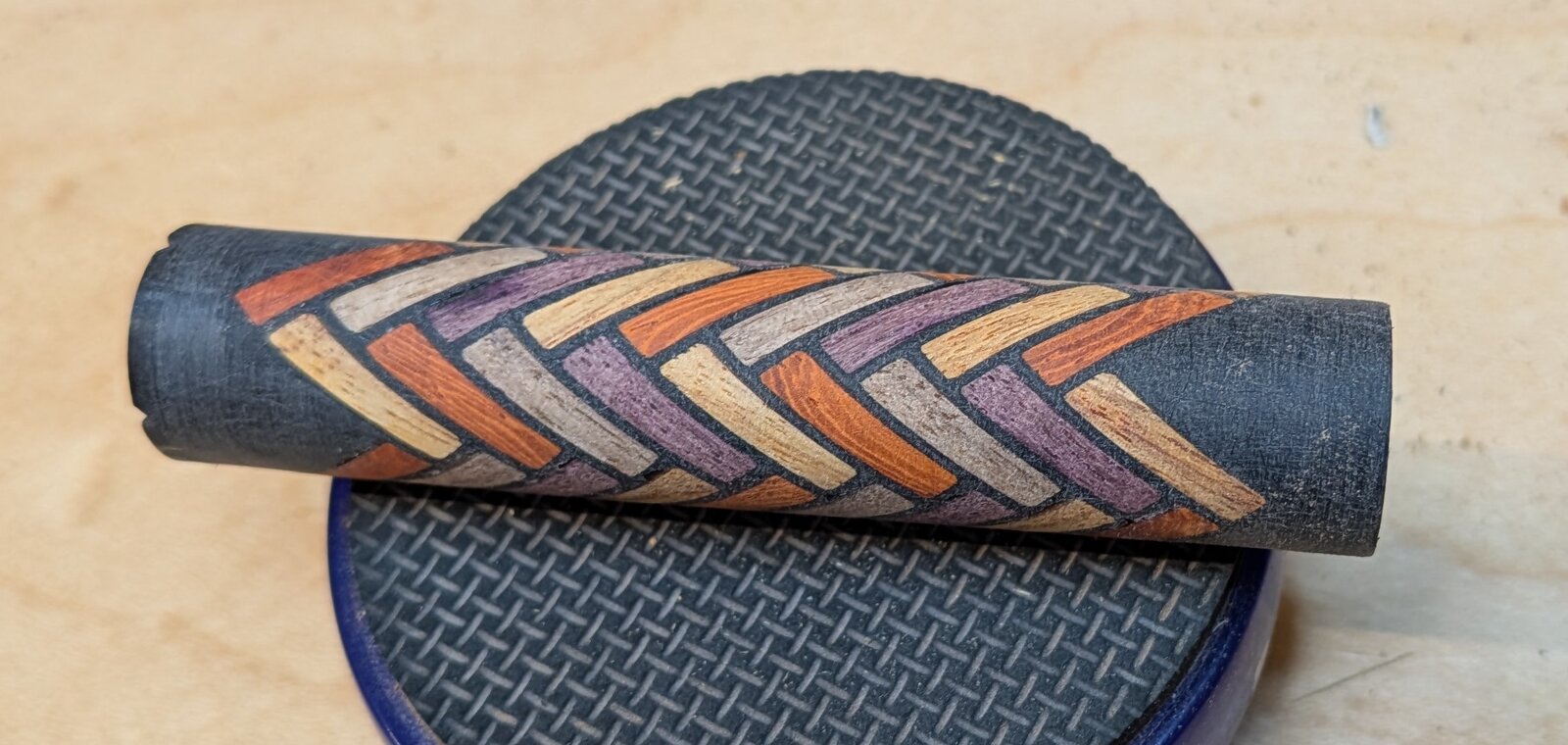

It"s been a few years since I did one. I did use triangles. If someone could possibly search my name and "basketweave" some pictures may be there. I'll pick up some material and give it a try and take more pictures this time.
As for what to do with the pieces that have end grain, don't try hide them work them into a pattern that spirals up the blank. If you can't hide something turn it into a feature.

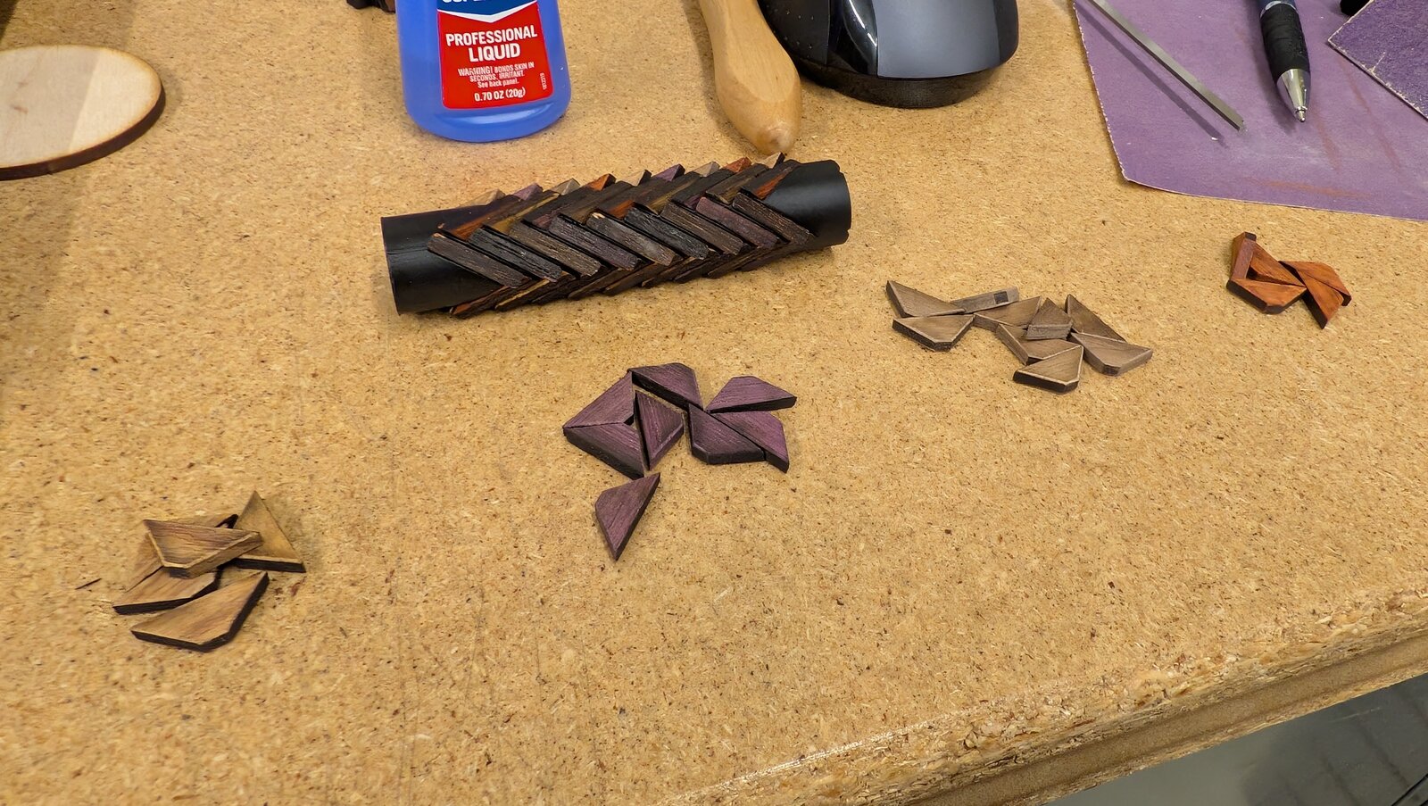

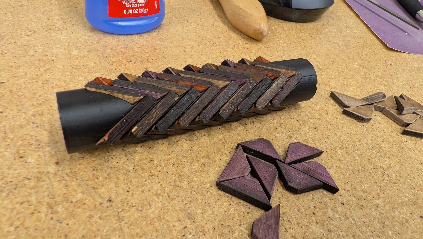

Here is a blank I am currently experimenting with. Purists will absolutely hate it, but....

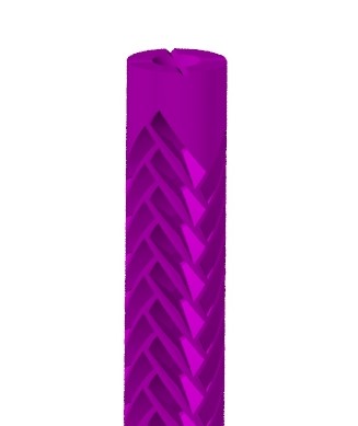

Anywhoo, I 3D printed a herringbone blank that receives inserts, which I first saw by @ochoabrian , who posted his herringbone jig idea. I modeled one up myself, and cut triangle inserts on my laser, with long edge of the triangles parallel with the grain. See photos attached. I also included a rendering of the jig (don't have a picture of the blank alone). I haven't finished this just yet, so not sure if it's going to turn out worth a darn, but I'm sure the wood inserts will all show as edge grain.

Also, a laser is certainly not necessary to cut the triangles. A miter setup on a table saw sled, or even small miter saw would work. Just flip the 'stick' of wood after every cut.
