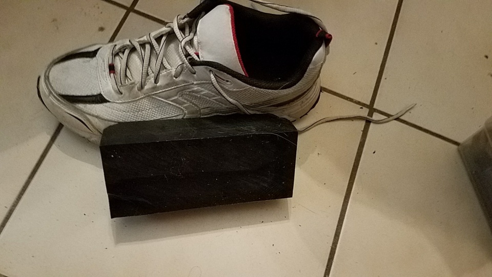

Certain HDPE plastics can be melted into blocks. Its any thing made from HDPE thats been injection molded not blown like milk bottles. HDPE for bottles is just a slightly different mix and doesn't melt nicely. The injection molded stuff melts down like thick wax.
I've been making blocks upto breadpan loaf size. Luckily I have an endless source of HDPE from work.
