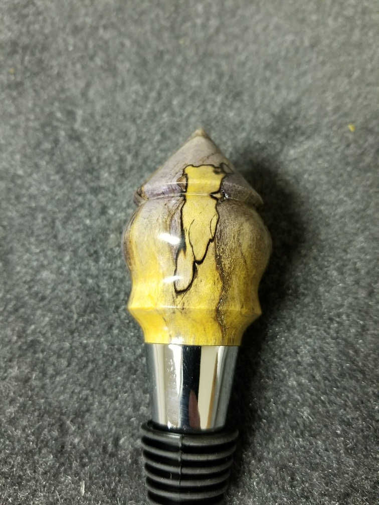

I'm experimenting with using dyes in CJ to create multicolored blanks. Like this one I did a few months ago.
The one pictured I simply placed the blank into yellow dyed CJ and let is soak up the yellow CJ, then placed it in Purple dyed CJ and placed it under VAC for 24 hours.
Surprisingly it didn't VAC all the yellow dye out and replace it with Purple, and it didn't seem to mix. What I am wondering is if I just got lucky, or can I expect this result each time?
Should I soak it in one color first, then cure it before VAC in another color to ensure they don't mix? Is there info some place on doing multicolored CJ blanks? How would you go about doing this?

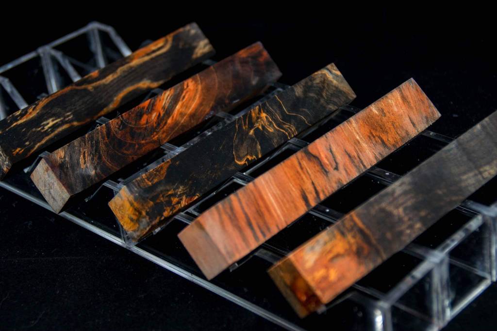

No and yes, it depends considerably on the type of wood you are working with, if you soaked the full blank and pulled the vacuum and then cure it, any other colours won't penetrate.
There are various ways to multicolour blanks while stabilising, again, the wood used will determine what method will work better, any soft or panky woods are the easiest to work with, some medium woods work better than others and very dense woods, you won't get any colour through them.

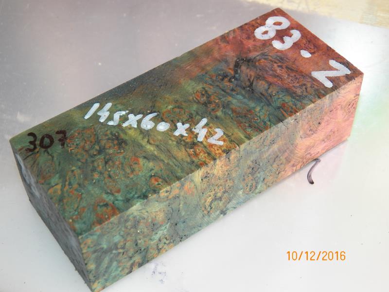

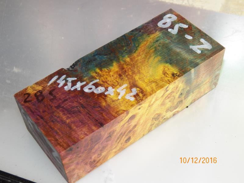

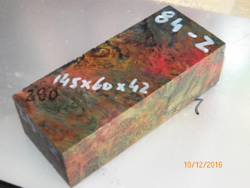

Drip system on softwoods is in my view the best method to introduce various colours into a piece of wood, the results can be spectacular, such as these blanks,
Good luck...!

Thanks George! good info, love the 3rd blank.
View attachment 171469View attachment 171468View attachment 171470
Good luck...!

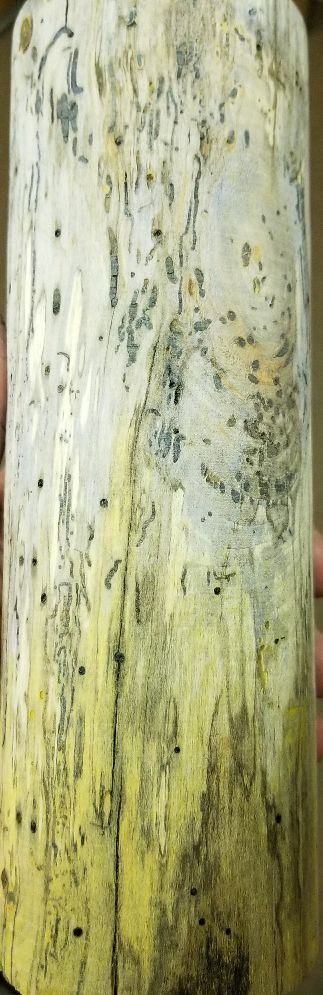

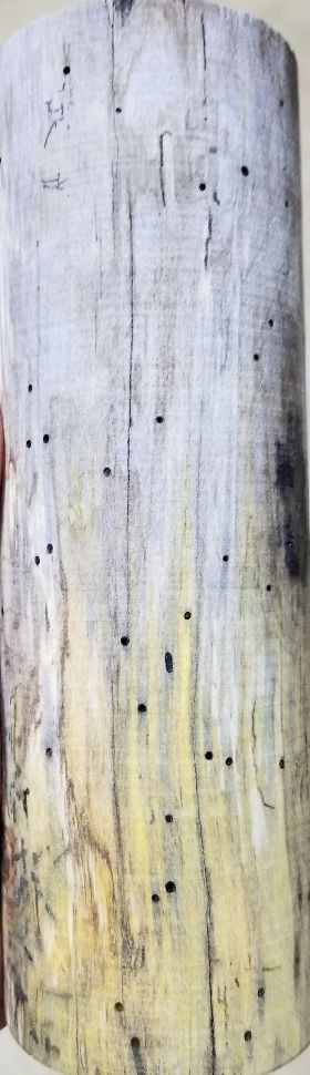

These pics suck so bear with me lol.
The colors are washed out in these pics, but the color yellow and purple are the same on both logs. Funny how the purple is washed out on one and not the other and visa-versa.
Anyways,
The first log was soaked in Yellow 1/3rd of the way for 24 hours. Cured then submerged in purple and VAC then soak. After that cured again.
The second log was soaked in Yellow 1/3rd of the way for 24 hours, NOT cured but submerged in purple and VAC. Then cured.
I thought for sure the second log would come out looking sh*t brown because the remaining dye sure looked Sh*t brown. But to my surprise, it don't really look any different than the first.
Seem odd to me, but it appears the dyes won't mix once saturated in the wood. I know it is hard to tell in the pics (I should have shot them side by side but not able to now) they really don't look any different when held side by side.
Hummmmm curious.
