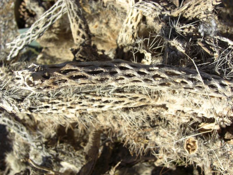

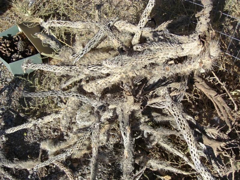

I have cast some and I find that if you stick to the stuff that is closer the the 3/4 size you will get better results. I cast mine in 3/4" PVC and I make it a little longer (6") so that I can pour up to the top then place it in the pressure pot. Under pressure your resin will compress and will drop as much as a 1/2" leaving you with a 5 1/2" blank. If you have what I call knuckles (lumps where another piece was attached) you can sand them down to fit in the tube, some of these will give you a tier drop shape instead of a diamond. I wedge the cholla in to the tube at the top with a small piece of wood so it wont float. As for buying it I can't help there, I live in the desert and just go out and pick mine up. :rolleyes: I picked this up on Monday. :biggrin:
