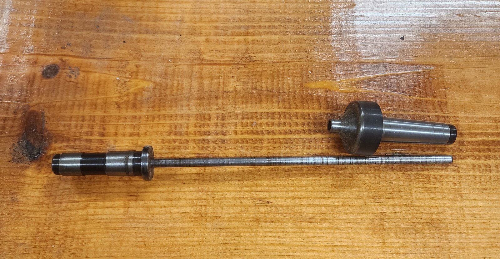

Thanks all. I'm embarrassed to say I purchased an Axminster saver without the compression package. It fit over only one of my mandrels! The difference in diameter was barely measurable even with my 3 decimal point digital calipers. So I sanded the mandrels down. This was going great till the 5th and last one. I carefully slid the saver over the sanded portion as I'd been doing but found I could not pull it off. And no amount of tapping up to hammering could remove it. I finally asked for man assistance only to watch both the mandrel and saver come apart, with the mandrel still in the saver's opening! After he said "what the hell, it's ruined anyway" and picked up a small sledge hammer could I see a scored line where it had finally move an eighth of an inch. I can only believe I must have caused a burr at the rim of the saver opening but I remain stunned at how little force it took to get it stuck!
In researching once more for a mandrel saver I can count on, I've read that bushings are a bit loose on the mandrel that comes with the Axminster compression system. And that their bushings don't fit over standard mandrels. But come to think of it I've just sanded all my mandrels down! I don't want to go with a TBC system for two part pens as I like designing both together as I turn.
