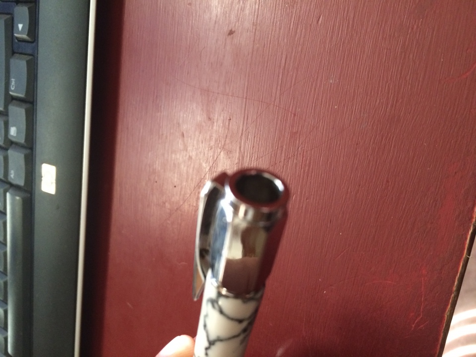

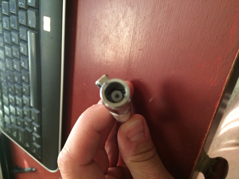

The mechanisms are what fail the most. I have a Vertex click pen where chrome click mechanisms snapped off of the post holding it. I've turned pens with titanium or rhodium finishes, but I hesitate to do anything too nice because it seems the internals don't hold up very long. The best luck i've had is with fountain pens, absolutely no issues. Click pens and their internal mechanisms fail me worse than anything else. Any recommendations to different kits/suppliers are welcomed! Thanks.
Dan
Click pens are probably the most temperamental, however the Vertex is one of the most reliable, I don't think the plating has anything to do with it. I have turn a lot of Vertex in chrome and gunmetal and never had a problem. When I went to first do a click pen I settled on the Vertex and the Stratus (which I think is the same mechanism as the Vertex) because of the reviews I got from doing searches on this site. As someone else said, the real cheap cross styles sometimes have problems but they are transmission type slimline type. Maybe if you had pictures of the failures someone here could let you know what was happening. Maybe it is an assembly problem and someone else has had the same problem. You also should contact the people you bought it from and ask them.

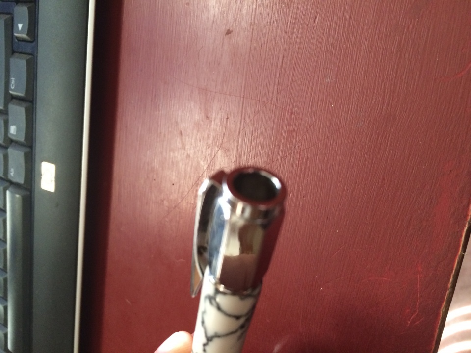

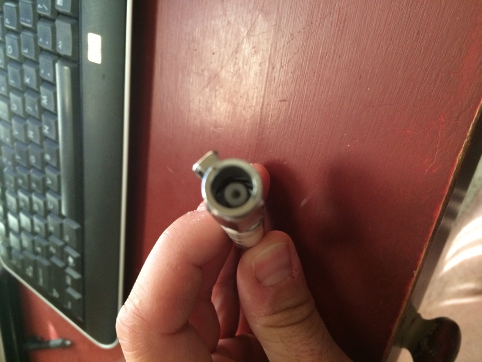

I threw away the actual chrome click piece, but this is where it broke off from the rest of the mechanism.

I too had had a problem with the Vertex click mechanism with a 100% failure rate when I dropped them. Like a cup cake they always land top down. What I do, based on some other conversations on this site, is to take a tooth pick and with a little sanding insert it into the hollow part of the click mechanism as a reinforcement to the vertical click part so it fits nice and tight and filling the hollow part of the click mechanism completely. Since inserting the tooth pick I have not had any failures.
The Vertex breaking off the clicker when it is dropped is a known problem. PSI also is aware of it. Spoke at length with their customer support about one that broke.
The tech suggested I super glue in a small 18d finishing nail with a drop of medium superglue. I do that now and it seems to work, though I don't know how many have been dropped after repair.
