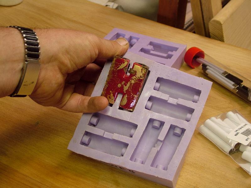

I don't use PVC, so I'm not sure. I use these. (pic)
The 'slimy' tube sounds like the resin wasn't cured. It might be 'set' but
still in the process of curing. As for the fractures.. I really couldn't guess.
That sometimes means too much catalyst, but the slimy usually means
uncured resin.. too much catalyst wouldn't give you uncured resin unless
it wasn't mixed in well. In that case you might get pockets that remain
uncured while other spots got too much catalyst and overheated..
Not really sure though.
