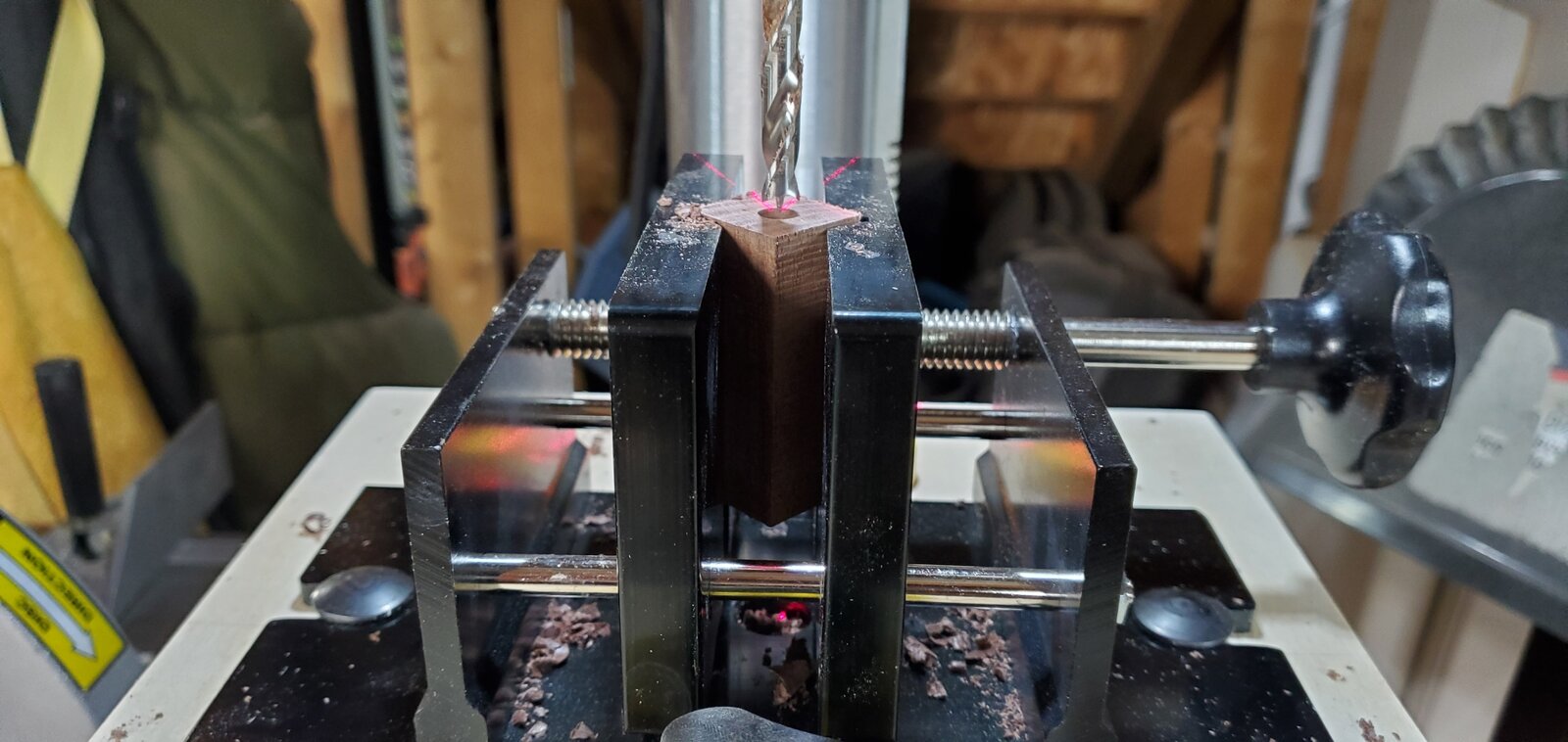

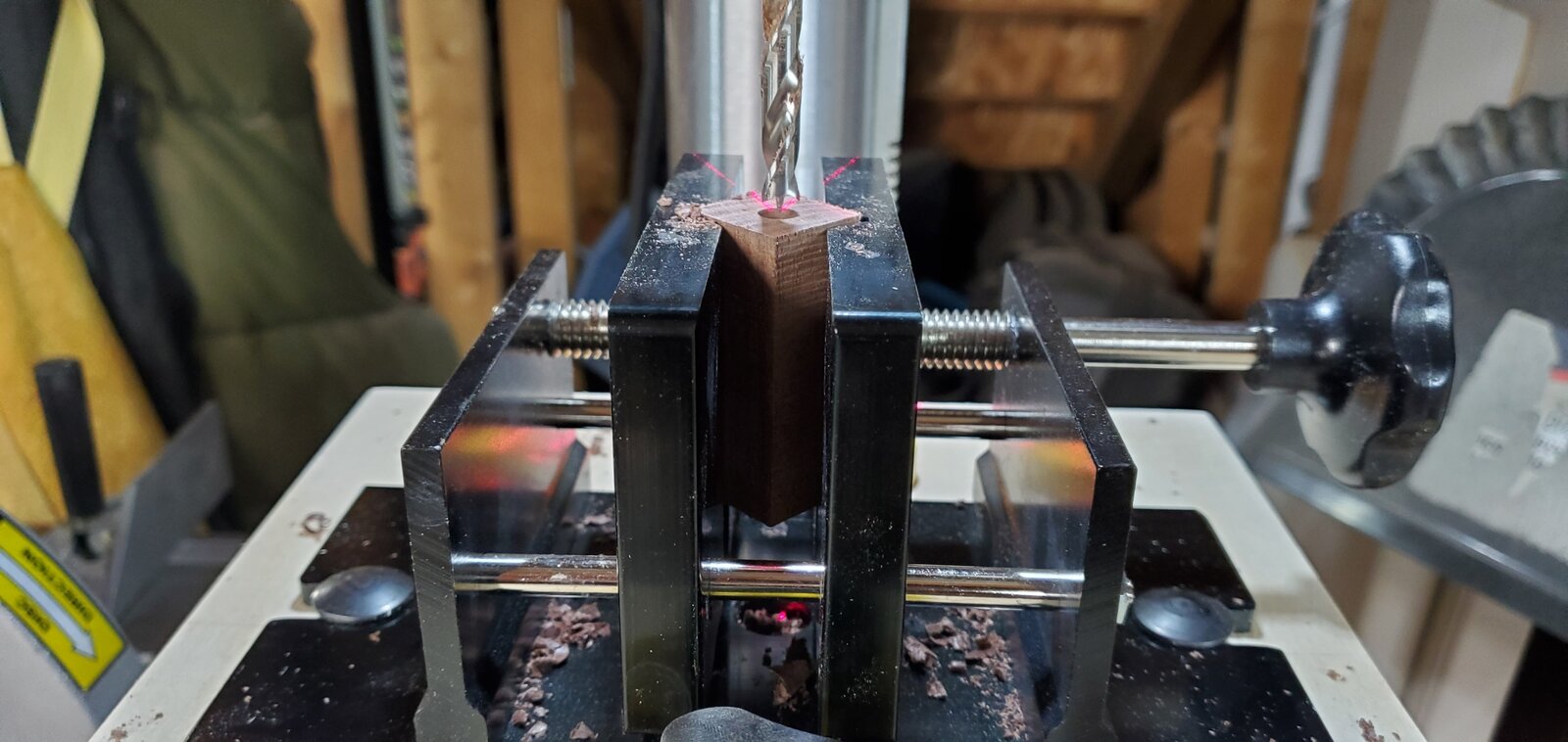

My Woodcraft Pen Blank Centering Drilling Vise arrived a week or so ago, so I spent some time figuring out how to best use it.

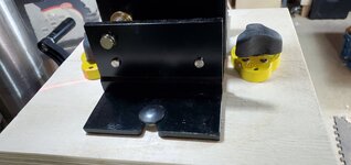

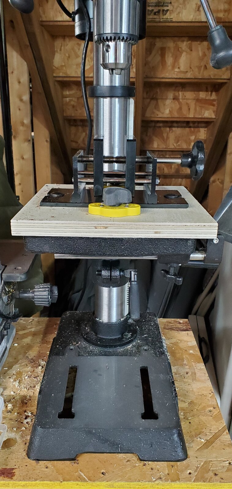

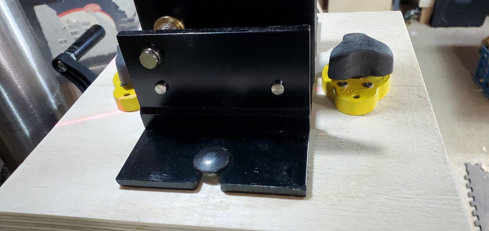

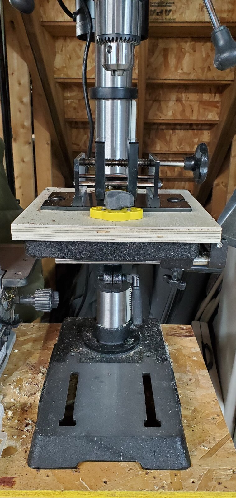

I mounted it on a piece of 3/4" plywood, cut to size for my drill press' iron table, and drilled holes for a pair of MagSwitch MagJig 150s for holding it down without clamps.
Now I can quickly and easily get the whole thing centered, turn the switches to lock it down, and get good repeatable results.
Getting good repeatable centers has been an elusive task for me as well. I have this same vice, and clamped it to my drill press table, but it would still drill off-center. I think one of the problems is the difficulty in holding the vice in the right place while trying to tighten both clamps. With this setup, I can use a ~10mm shaft in the chuck and clamped in the vice, then just turn the knobs on the magnets to secure. Thanks for sharing!
