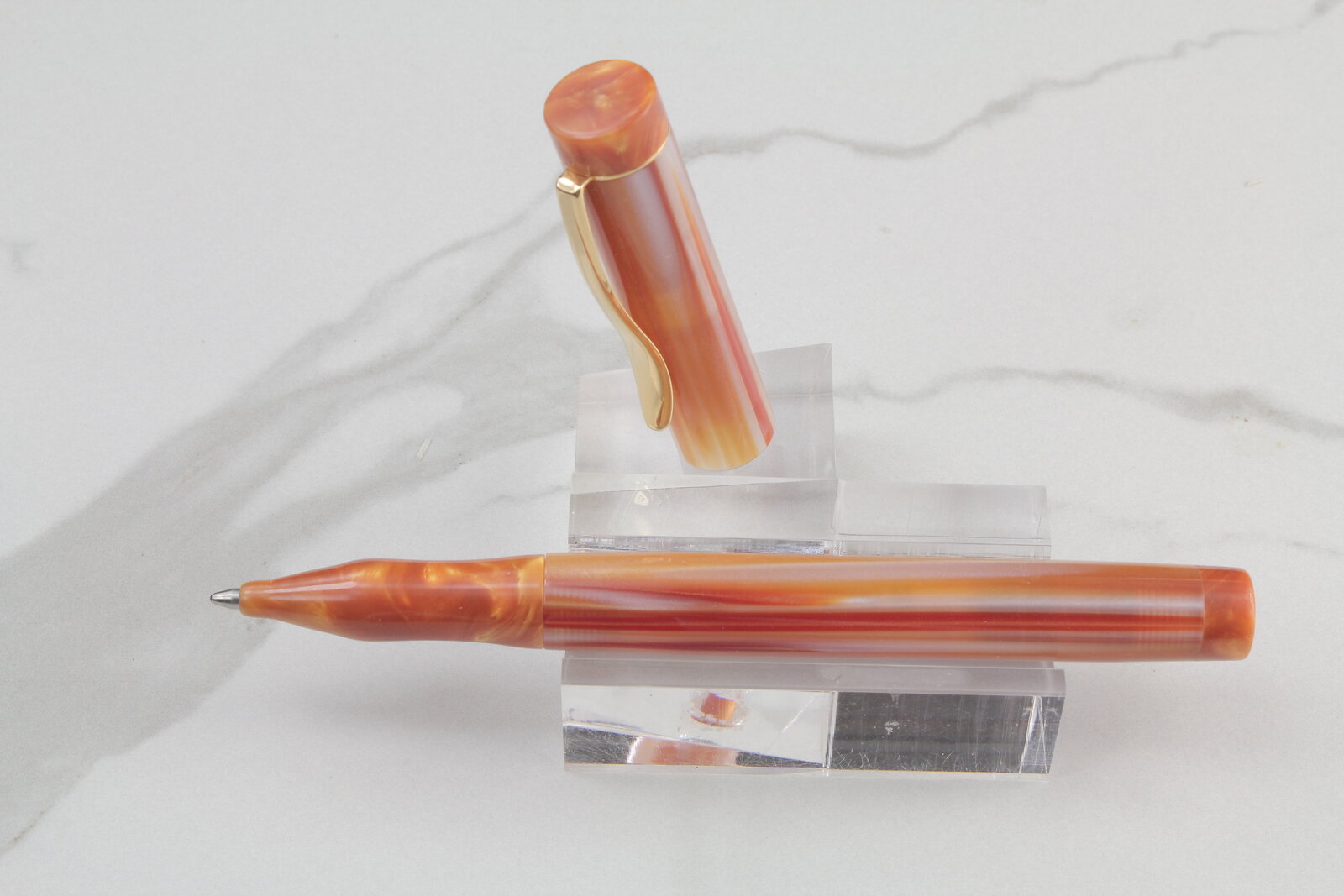

Locked taper using matching 2 degree taper on the cap and body. Think about how a morse taper holds. Force required to separate cap/body 5-9 pounds. Bubble tight to at least 15 psig. I also taper the end of the body so that the cap is postable (if desired). Cap can be removed by pulling, twisting clockwise or twisting counterclockwise.
I focus on ballpoint & rollerball mainly because my budget doesn't allow for me to keep FP nibs/feeds and due to my location in rural South Dakota. Drilling the section to accept a FP feed would only be using a different thread
Locked taper example
