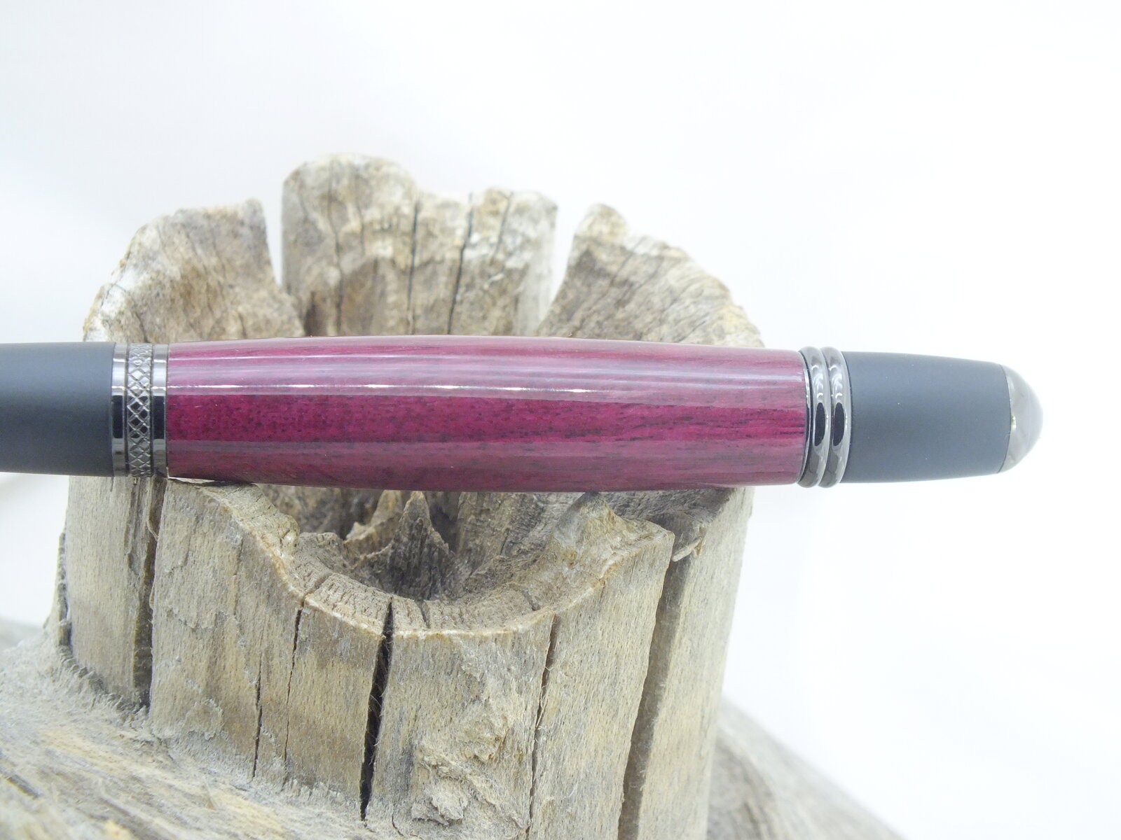

I purchased a toaster oven at a second-hand store and then made a quick jig consisting of a block of wood with a long finish nail in it.
I hang the turned and sanded pen blank on the nail and then "cook" the blank. It's amazing to watch the blank go from muddy brown to a purple grape color.
I will watch it closely and rotate the blank every 2 minutes or so. This will help get a consistent purple color all around the blank.
After that I go through the typical CA finish steps.

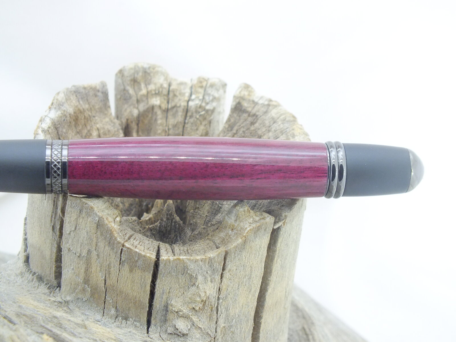

Very pretty. Would you mind sharing the temperature you cook it at and for how long?
Usually around 350-400 degrees on the toaster oven dial, but I'm not sure how accurate that is. The time will vary depending on the wood but around 8-10 minutes.
You'll want to experiment and watch it closely. I've had a few go too long and they got too dark.
It seems like they continue to darken a little after taking it out of the oven so you might want to pull it out when it's a little lighter than what you prefer. I think the CA tends to darken and deepen the purple as well.
