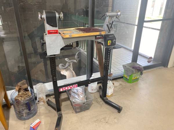

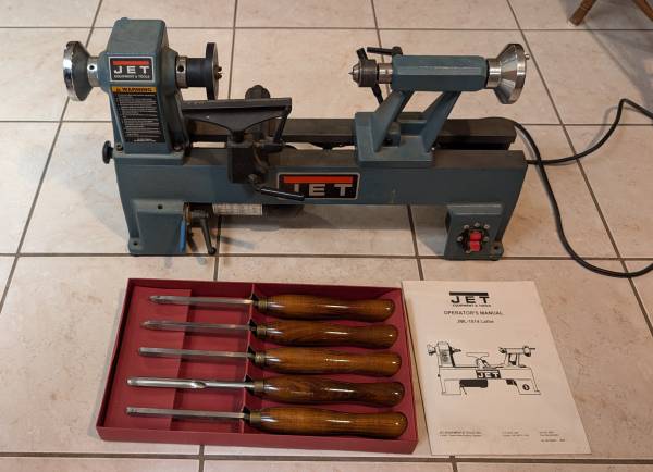

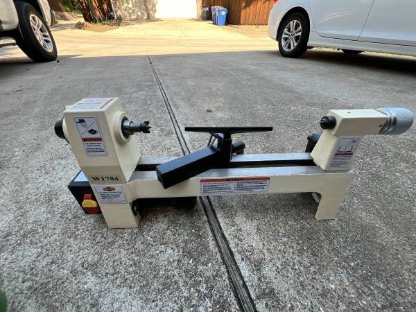

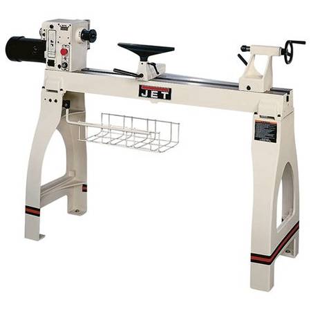

Your profile says Dallas.
I'd buy a good looking lathe on Craigslist.
You could get one of these today and be on your way.
I'd be inclined to the first one below.
This is an excellent and well researched answer. I for one applaud you for a fine post. Secondary market tools can be a very good jumping off point.
