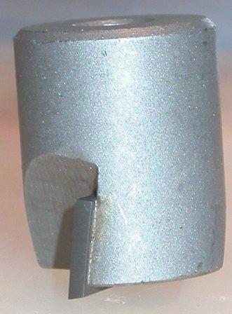

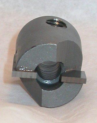

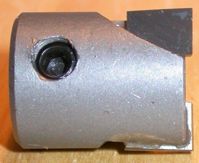

Well, of course I didn't get the barrel trimmer on Friday, and since I use my work address, I didn't get it Saturday, either. But it came today! I just opened it to take a peek, and it's odd. There are only two cutting blades, rather than the traditional four, and the shape of the rest of it is interesting, too. I'll try to take pictures tonight when I get home. I'll also see if I can't get some shop time tonight or tomorrow night to take it for a test drive.
No time to get out and play, but I did get to take some pictures tonight. Here are some close-ups that hopefully will help you understand my earlier comments.

Actually, I can see a potential problem with the thing and that is that the carbide inserts aren't replaceable. I was a machinist for a while many years ago and we always had problems with carbide cutters chipping. The inserts were easily replaceable. Chipping may not be a problem with wood, but if you drop the thing, it might chip.
Maybe I should have said not easily replaceable. The inserts on the cutters I used in the machine shop had a hole in the center and were held in place by a set screw. When they got dull, you could just loosen the set screw and rotate the insert to a new edge.

This is a std reverse spotfacer available in industrial supply houses. You can also use an interchangable pilot counterbore that uses a 1/4" pilot - replace with D drill rod. Get it in cobalt steel and you have something that'll last a long time. These things CAN be sharpened
