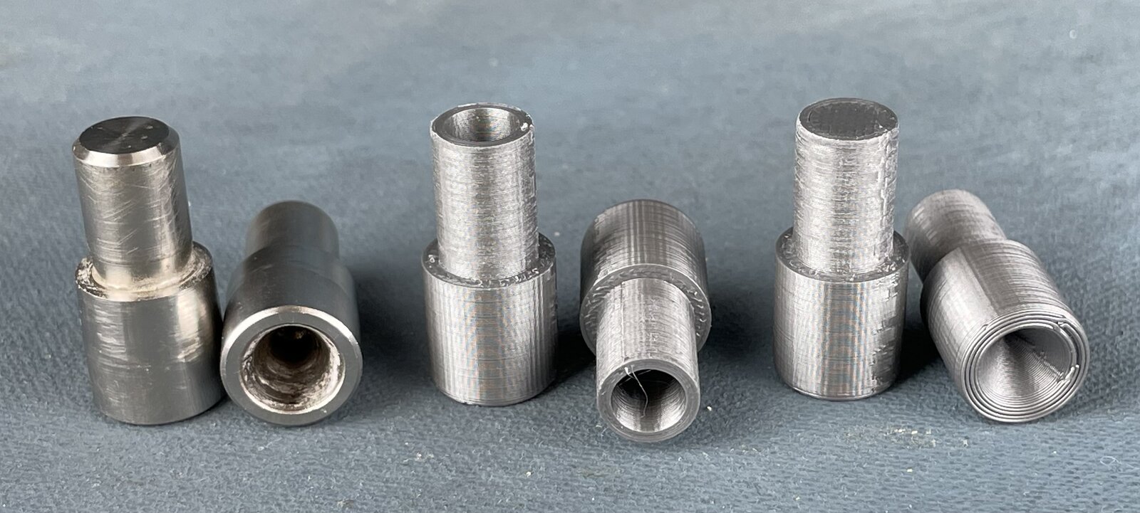

Sorry I forgo to mention that Also there are this options:
Have you done any turning with those? Any risk with part of them sheering off during turning (due to the layering)?
They just work like stainless steel ones. I've spent many trials to get the size right. I use them for sanding and buffing, but have used them in turning pens instead of my Nikitas SS TBC and they just function perfectly. I have used several brands of filament and settled on Hatchbox performance PLA. Matte, but strong and very smooth. They don't separate at the layers if you use the right 3D printer and the right settings.
Shortly, I'll start selling them at very reasonable prices.
