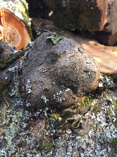

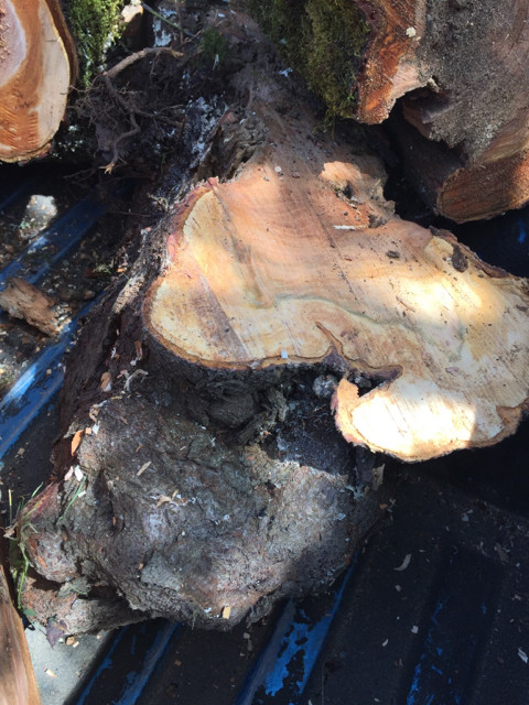

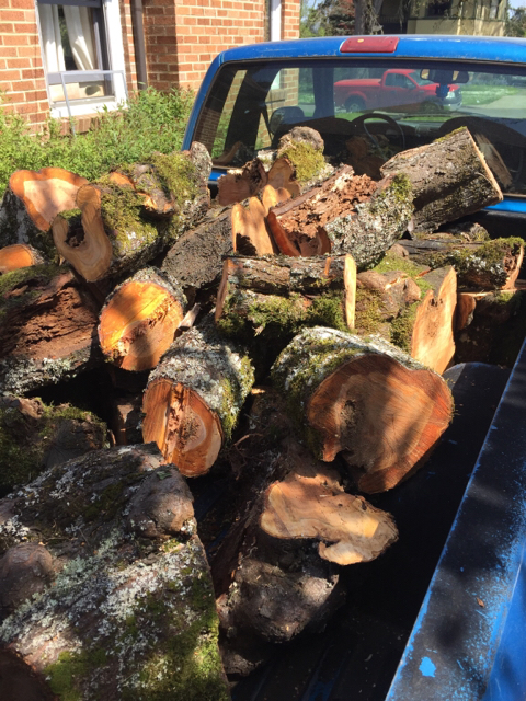

Hey all,
One of my neighbors had this cool cherry blossom tree that they cut down yesterday and graciously allowed me to take the wood.
I'm looking for tips on the best way to process this for pen, bowl, and bottle stopper blanks so that I don't lose 90 percent to checking...
I don't have a chainsaw, but do have a 14" bandsaw.
Is it best to cut into smaller blocks, seal the ends, and let it dry for a long while, then process down into blank size? It also has a lot of fist size burls.
Thanks!
Eric

Thanks all. It was cut yesterday and some pieces are already checking pretty badly. I'll trim those and seal it.
