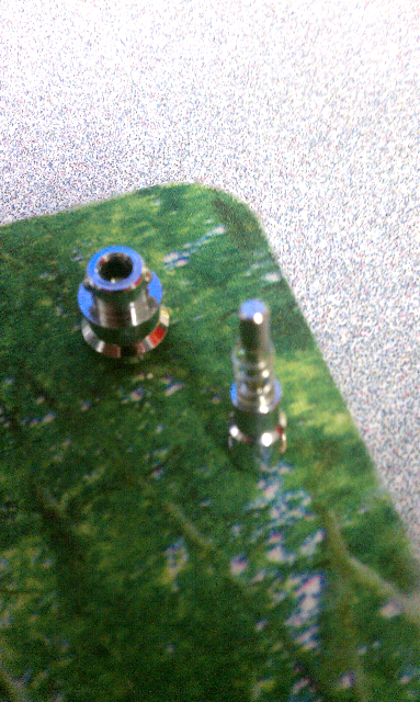

I am not seeing a screw anywhere. Either it is super small, or this psi one doesn't have it.

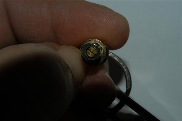

Berea where the ones i had problem with. I don't think there is one better than the other ot that it is a "kit" defect. Just that the assembly is somtimes a little "neglected". Locktite might not be essential if you thignten this little bugger well but i prefer not take chances. I lost my keys once because of that little screw.

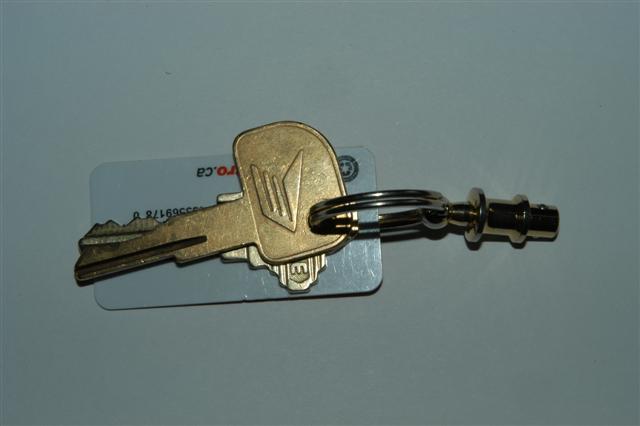

Take the part that remove from the keyrong, look inside the plunger it's there. Push on the plunger while holding it and it pups out.

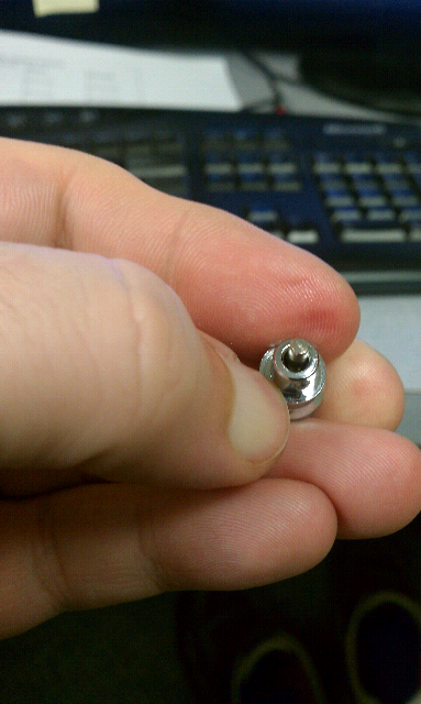

Yeah, mine is way different from the berea one. Must be a better design for the one you have. Thanks for all the help.
