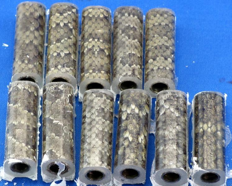

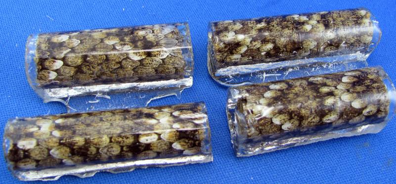

Maybe you are scraping off too much. You should only be removing the scale cover flaps. What rattlesnake skin are you using?
The skins in the pictures have had the scale flaps removed.

I noticed that applying a small layer of 5 min epoxy and stainless braid really with the air bubbles disappearing, but it seems as though after scraping the scales off of the rattlesnake skin, it looks ugly as hell and kinda doesn't even look like snake skin.

Wow,
The blanks on the left are what mine look like, I am removing all of the scales...maybe I should just remove the clear scales not all the scales....Thank you so much for the pics that really helped.
Do you pressurize your blanks or just remove the bubbles by hand, and let air dry?

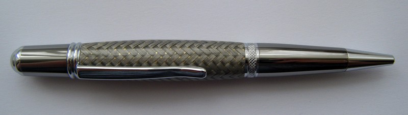

I experienced the same issues with the stainless blanks so I changed to using braided "tinned" copper wire. They are not as bright as stainless but so much easier to work with, I can cut the braid with a normal pair of scissors. As far as snake blanks goes, we don't get too any rattlers over here:wink:
Eric...

No, I do not use pressure. I do use an ultrasonic cleaner.
