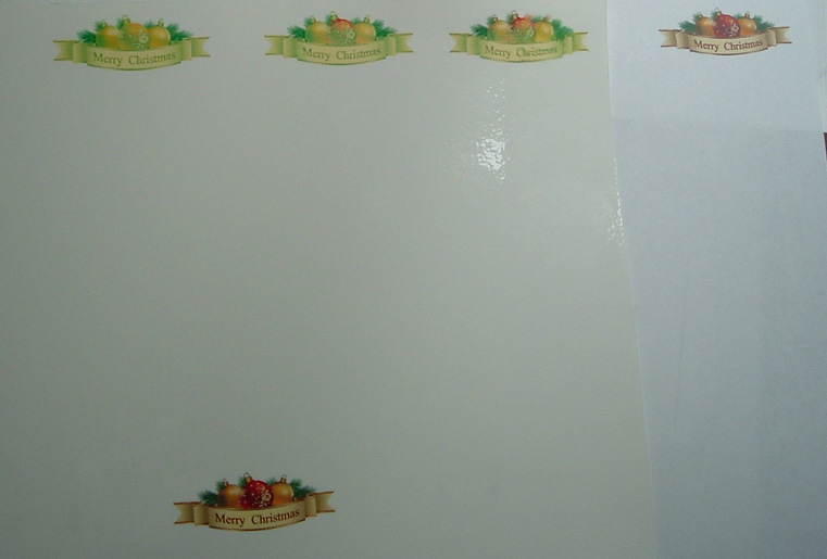

I tried to print a very colorful label abut 1/2" high and 2" wide.
After I had everything set up on a test page in photoshop, I printed the label to what I thought was the top edge of the paper.
However, somehow the setting got changed and it printed to the center of the page.
That label looks fantastic and is exactly what I was wanting.
However, I'd rather not waste a whole sheet for one label.
So, I tried 3 times to print the same image at the top edge and it comes out ugly, colors are wrong and it is smeared.
Anyone else have a similar problem printing at the edge? Or maybe the paper is not properly supported in that position?
I'm using a good HP inkjet, on photo paper setting.
I may just cut out that label with a knife and try later to print on the same sheet...that might work!

Well, I was thinking maybe the ink level was lying to me so I printed the image on plain paper in the upper left corner, high quality color on plain paper. It printed fine.
Attached are the prints, sorry for the poor quality of picture as the glossy paper was giving me problems.
The 3 images at the top that are mostly green are the bad ones.
The one in the upper right is the plain paper and the one in the middle is the good one.
I'll need to do more testing to see what is happening.
This was for a one-time pen as it is Christmas themed and I didn't want to print more than one.
As for photoshop, that is the only program I have found that allows me to take a large hi-def image and print it in hi-def smaller scale. This image is about 8 times this size in Photoshop. If I don't do it this way the reduced size image looses detail a lot.
