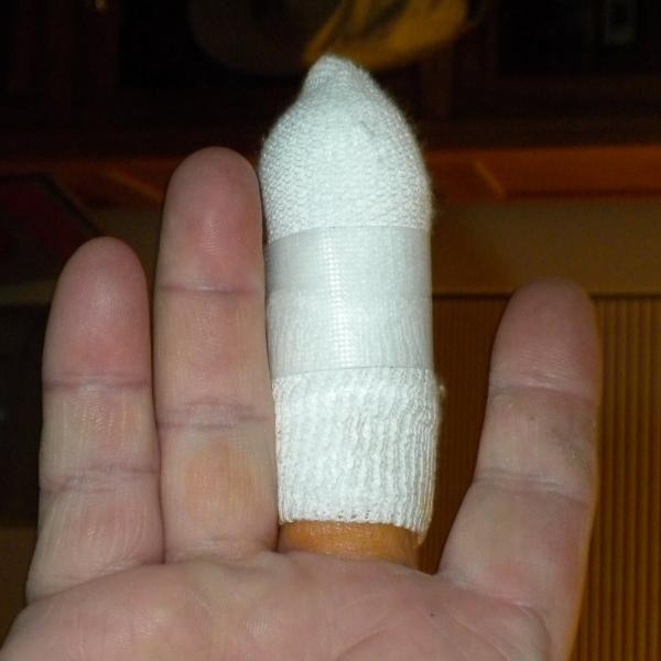

New Barracuda 2 chuck for my lathe $179.00. Six hours in the ER after it came flying off the lathe after a catch and played pirana on my finger PRICELESS! Really, NEVER try to catch a 15lb chunk of steel moving at 5000 mph through the air!

I was turning a small piece of wood when I had a catch. The instructions say to stop the lathe and check to make sure the chuck is still tight against the head stock if this happens. I reached over shut the lathe off and as it decelerated the chuck came flying off and even though I was standing off to the side my natural instinct was to bat it out of the way as it came flying off. My guess is I didn't have it tight enough to the head stock to begin with and physics just took over. I chewed up the tip of my finger and part of the nail but was actually lucky I was standing off to the side, it could have been worse.

Actually, the first thing I did was check the chuck to make sure it was OK (priorities you know) the blood drops on the floor alerted me to other pending issues :} I must have hit some nerves because its not hurting as I would expect it to. (The wife keeps mentioning brain damage) All in all lessons were learned the hard way but the chuck is good, the finger is healing, and I keep reassuring the wife there was no brain damage...she's not buying it!
I should add I know why the chuck came flying off now. It threads onto the headstock clockwise and the lathe turns counter clockwise. When I had the catch it loosened the chuck on the lathe. I shut it off and all would have been ok because the rotation of the lathe and the chuck were constant and equal and this was keeping the chuck from spinning off.(can you see where I'm going?) When I reached up and grabbed the handle end of the head stock to slow it down this allowed the chuck to spin off at full speed.......like I said lesson learned...the hard way.
