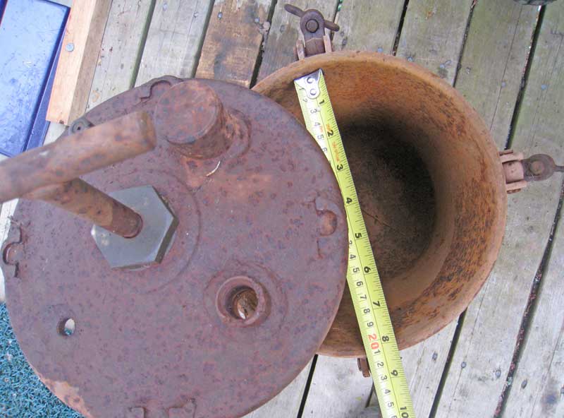

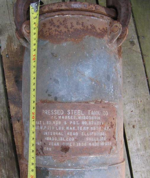

Price was right.... is it usable?
mywoodshopca
Nov 3, 2008
1,123
Charlottetown, PEI Canada, Derby Kansas and Canyon
Out at my grandparents today and came across this sitting down behind a garage.. this was sitting in a scrap metal pile for 10 years. The clampdown bolts turned free after some wd40 was sprayed on and used a wrench the first time.
The pot is pretty rusty inside, but nothing a bit of sandpaper wont shine up again.. Shes solid and heavy..
It might be difficult to get it cleaned up, and to be safe I would take it to
a place that repairs/refills fire extinguishers and have them do a burst test
(hydrostatic pressure test) Shouldn't cost much .. maybe $10. But they'll
put it in a pit and apply twice the rated pressure. If it doesn't blow up,
you're good to go. If it does blow up, at least it does so in a controlled
environment where nobody can get hurt.
Some EvapoRust, naval jelly, sandpaper, sandblasting .. whatever you use
to help clean up the fittings and especially the rim.. that should all help.
And a good silicone seal should help. If you put some vaseline under the
rim and do a bead of silicone caulking, you should get a good seal, or you
can use a gasket material.
But it looks like the price was right..
Thanks! Good idea about the pressure test.

In short ... NO.
You will spend far, far more time and effort in cleaning this up and that doesn't even include the cost of materials you will need, and then there is all the hours of work in sanding the sealing rim joint and the rim of the pot till smooth.
I personally would look at this pot as being a relic from good days gone bye.
IMHO I would seriously advise you to save your many hours of effort and get yourself one that is known to be efficient and logical and safe to use. I believe your time can best be spent turning...!
Now if you want to tinker around for many hours, then by all means have at it. Just remember it may still fail any test you apply to it after all the time, effort, etc., and then you will still have to go get a new one!

I don't see any problem with using that tank. Clean it up, put in a seal of some kind, and do the test. I suspect it'll be much better than the HF ones so many people are using. But, of course, I have a fetish for old arn.
