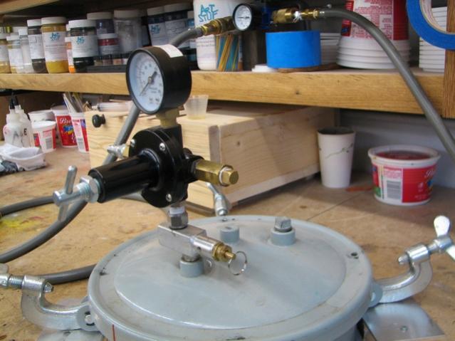

a little bummed to see that need to get all McGyver on this before I can use it. Thanks for the replies. But I ask one more thing. Are these modifications totally needed to start pressure casting? or only if I want to hook up the vacuum as well?

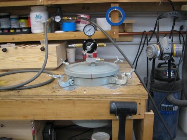

I just did mine today - took me a total of 30 mins to put together once I had all the brass. I went with the simple version with a dual gauge. All ready cast my first mold and will let you all know tomorrow how it went.
If you only want pressure, I would be happy to pick one up for you, do the conversion, and send it to you just for the cost of materials and shipping. I DO NOT do vacuum, though. If you are just going to cast, IMO, vacuum is unnecessary. I just did one for Reb (sorry Reb, have not had time to send it) and the post was around $80 with tax and the parts to convert it were $12. It only lost 3# of pressure in 10 days at 80 psi. Send me a PM if you are interested.
If all you want is to do pressure casting and you are 100% sure about your pressure regulator on your compressor then put a quick connect and a valve on the top of your pressure pot and a diverter (elbow) on the inside of the lid on the same connection (so you don't blow the resin out of the mold), set your regulator to your desired pressure up to (but below) the max the tank is rated for and then connect up your compressor.
The secondary gauge is to measure vacuum and pressure at the tank. The other ball valves are so you can cut off the pressure from the vacuum gauge and the vacuum from the pressure gauge.

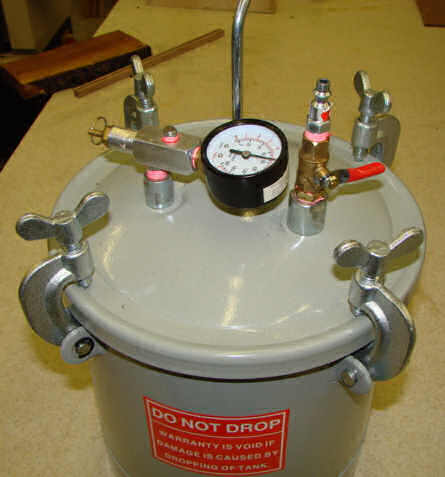

I spent VERY LITTLE, about $5, to convert my HF pot to PRESSURE ONLY.
Quick connect on the left and a plug on the right.
Close-up from the front.
This shows the other plug thats needed for the lid. With this configuration the pot will hold pressure with the hose removed. Nothing to it!:wink::)

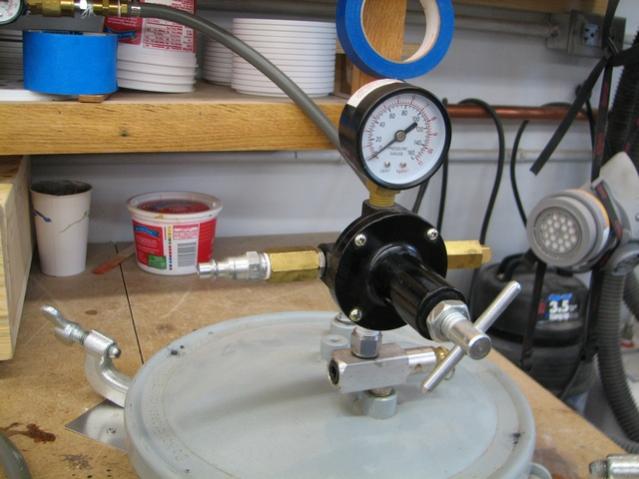

One thing to think about...ditch the regulator. It is just another area that can leak and more bulk to deal with. You need a cutoff valve so you can disconnect the hose once pressure up. If you have a cut off valve, simply close the valve, attach the air, turn on the valve until you reach the pressure you want, then turn off the valve and you are good to go. The regulator serves no purpose in this configuration. I have one on my original pot and it just gets in the way. Here is a pic of one I recently built for someone else...
The quick connect ($1.48 at Lowes) screws into the valve ($7.96 at Lowes) which then screws into a 3/8 x 1/4 adapter ($1.97 at Lowes) and then screws into the lid. The regulator is removed from the aluminum T that comes with the pot and that hole is pluged with a bolt of the right size that was then cut off. The plug on the end of the T was removed and the guage was screwed in there to allow it to be seen easier when the pot is lower than eye level.
In testing, the pot was pressured up to 80 psi. It lost 3# in 3 days and then held at 77# until I released the pressure 10 days later!
thank you mesquite, I used the method you posted at the top of page 2 here, but the pot I got looks like the 2nd one you show here. I have a leak in the unused port. It's one I didn't touch other than to cap it off, which means it came that way. But I've allready cut the pipe so, no warrenty. I twisted it in a few directions and it reduced the leak a bit. I only lose about 4 lbs an hour now and I dont want to make it worse, so that's the way it's gonna stay. Thanks again, everyone. I am lovin' the PR !!!
