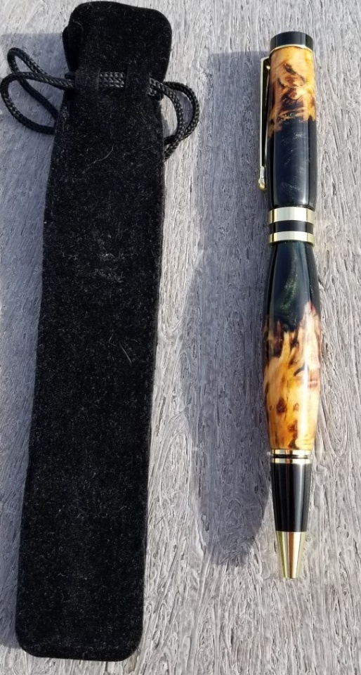

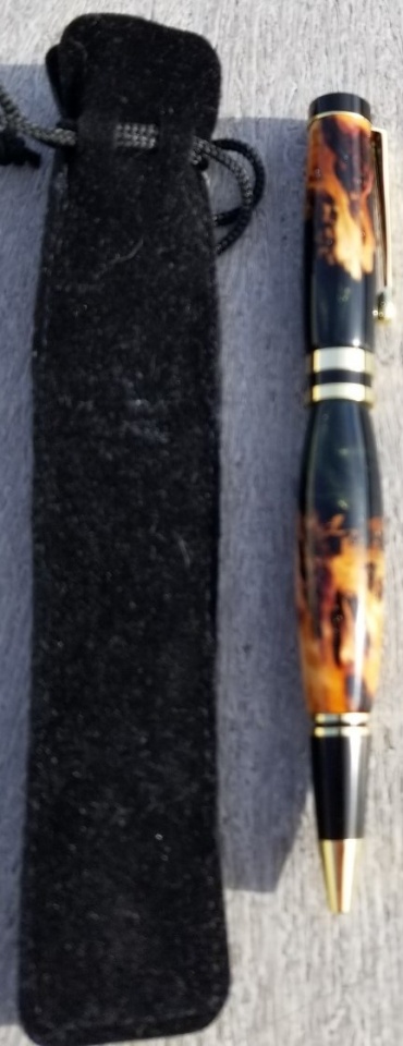

I have used this about 4 times now with cactus juice and it has worked flawlessly. I did have some shipping damage, but lab 1st handled it immediately and at no cost to me to make it right.
Cheapest kit I could find with an actual vacuum pump and I can reliably reach -29.5" Hg with no issue. With the 3CFM pump this can be done in about 5-10 minutes depending on what shape the worthless wood is in.
The out gassing of the material takes MUCH longer ~ 1-2 hours for it to stop bubbling.
I follow this up with 2-3 hours in a toaster oven at ~225 to cure the cactus juice. After trimming/breaking stabilized wood to desired sizes I put into molds and preheat to about 200F. Mix alumilite at ambient with multiple colors and pour into preheated mold. Put in pressure pot at 50psig for about 1-2 hours depending on which alumilite I use. The preheating is huge for a proper cure and no bubbles (at least for me anyway).
Just wanted to share my two cents.
See the two pictures attached as examples of my first and second try.
No bubbles or voids realized when turning.
