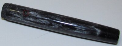

.... I have done a black blank where I used a piece of black PR and a piece of Alumilite Clear dyed black and .....
As far as I'm concerned the black die Alumilite sells is pathetic! I have been a loyal Alumilite customer for several years now and have made hundreds of blanks using their white, water clear and finally their crystal clear but am looking for an alternative when it comes to making pure black blanks.
Their other dies work great but I'm fed up with wasting time and expensive material mixing the crystal clear with their black TAR, which they refer to as black die. I can mix a 400 gram batch, add the black die (which you have to thin with part "A" to even get it out of the bottle) then stir the heck out of it, only to be turning a nice blank a few days later and hit a pinhole size gooey "TAR pocket" then have to trash the entire blank.
I believe these gooey tar pockets are very tiny bits of die that regardless of how hard you mix the resin, stays suspended in the properly mixed resin and being black, you can't see it when mixing.
The only thing worse is to spend time cutting down a small fountain pen section, drill and tap it and the LAST step is to shape the grip THEN turn into one of the dreaded "TAR pockets". I've trashed more work because of this and Alumilite's answer to the problem....... Yeah, that's just how it is! :mad:
Since you have their ear, why not get them to give us a black die that will actually drip out of the bottle like all their other colors rather than having to dig it out with a Popsicle stick?
If anyone is considering making black blanks or using black die with other pigments, I would say THINK TWICE before considering Alumilite.
Hmmm, I have used a lot of Alumilite black dye and have not had the tremendous troubles you have, George. Then again, I am not thinning mine with part A. I use odorless mineral spirits and just do not have the level of difficulty that your post indicates. Just pour in a little odorless mineral spirits, put the cap back on, and shake the hell out of it. I remember recommending this to you in the past. Has this not worked for you either?
Also, if you are needing black, why not use either of their resins that are already black and not have to mess with the dye? When I need pure black, I use Alumilite RC-3 Black or Alumilite Regular Black, depending on what I have on hand at the time.

Hmmm, I have used a lot of Alumilite black dye and have not had the tremendous troubles you have, George. ......
Hmmmmmmm back at ya! I figured I'd be called either a liar or an idiot that doesn't know how to stir a stick or spatula so I took a photo of a pen that I had a considerable amount of time invested in when I finally encountered the black goo pocket. It doesn't take much to ruin a pen, just half a pinhead size glob creates a nice little crater.
......Also, if you are needing black, why not use either of their resins that are already black and not have to mess with the dye? When I need pure black, I use Alumilite RC-3 Black or Alumilite Regular Black, depending on what I have on hand at the time.
Why not....... because I also use black with clear and other color dies to create different looks when mixed with different PearlEx powders. Here is (WAS) a lower pen body where I bond a solid black finial then blend the parts together to create solid black merging into a shimmering dark silver look. I made and bonded the finial, drilled and tapped the body and was turning to the body to it's final size when I first noticed the tiny kidney shaped blob deep inside the blank. Scratch another hour and more money in the trash!
Alumilite recommends thinning the black die with part A so I just follow their recommendations.
