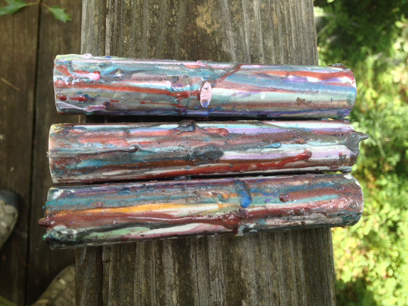

Here are some of my typical tubes. Well, Ok, these are maybe some of my older tubes, but you get the idea.
i leave a little room at the top of my pvc tube then i turn it over place it on something solid then use a pen blank that i turn to fit inside the tube and tap it out.........99.9 % of the time that works.....
I use my tubes about a dozen times before replacing (PVC pipe is cheap). Using a release agent like Pam does help.
My first reaction was that these weere some funky looking blanks that would make some awesome looking pens. Then I re-read what they really are. :redface:
