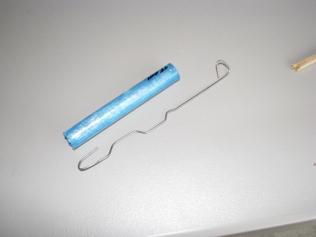

What are people using for mixing PR on verticle pours? If I use a popsicle stick I get to much mix. I would like to be able to get distinct swirls not blends. Pictures would really help.
I got some of my sons guitar strings when he change his strings last time. Cut them to about 7 inch lengths bent them on the ends. Before that I used broken scroll saw blades or whatever else I could find. When my son casts he uses bailing wire to make the swirls.
I'm still experimenting, but this one worked well for my first pour. Just a piece of stainless steel welding rod that I put some bends in to make the colors swirl.

But only rarely. Most of the time, the differences in weight between the different colors causes them to swirl all on their own.
On vertical pours, I don't generally try to swirl them by hand. I usually swirl them as I am pouring. For horizontal pours I use a toothpick or paperclip or something like that.
