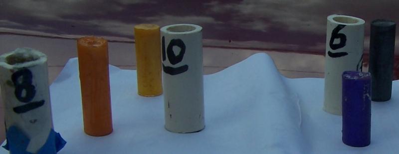

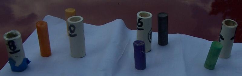

This is how I did mine. I know they could be bigger. I was making some to use as "display" colors.
