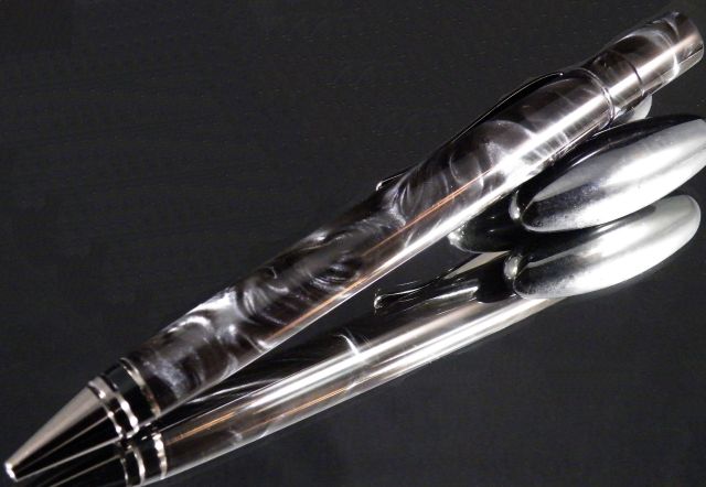

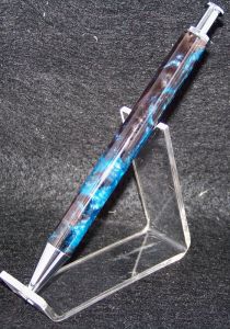

Most of the coastal scents mica and glitter powders are $3 to $5 per ounce which makes allot of blanks and turns out to be cheaper then the dye , MOP powder combination .

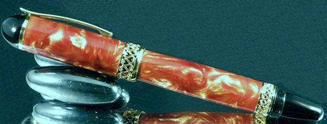

This pen was made with Bronze pearl mica from coastal scents

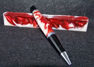

And this one is Black pearl mica
Nice pens Butch. I see what you mean. I had assumed that blanks like that were achieved by swirling 2 different colors of resin. The MOP I used makes swirls, but not with anywhere near that much contrast.

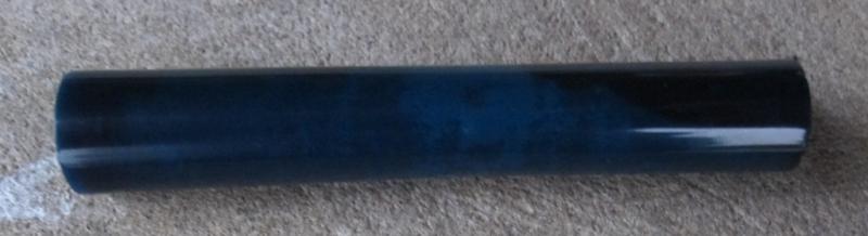

This is what I got with fiberglass resin, Blue pigment and MOP. Picture sucks - it was raining out so not enough light.
The PR blanks are similar, but a brighter blue overall because the resin was clear.
Edit: The left side was buffed to white diamond and the right to blue rouge. Not sure the difference in the pic is due to the pic or the buffing. I'm surprized it is noticable in a photo.

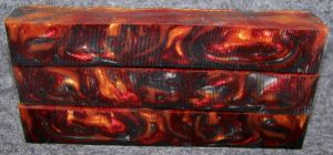

You can also check out a bunch of blanks here: http://www.penturners.org/forum/showthread.php?t=64594
Here's some samples of other types of pigments/dyes:

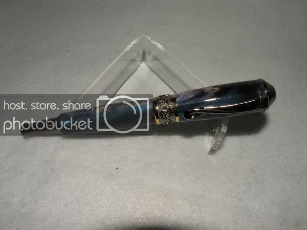

This one is testers enamel paint:

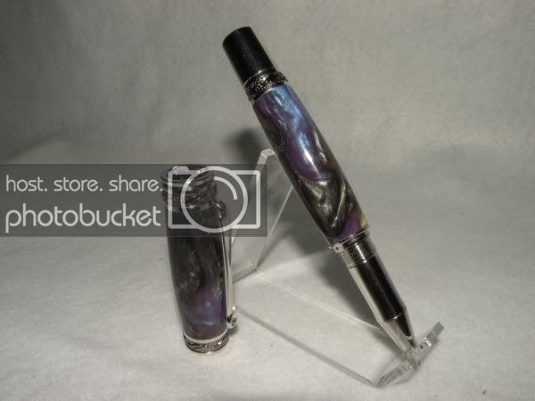

And this one is Black alumilite dye with a pinch of pearlex and electric blue mica:
And just cause everyone else is doing it....mica only:

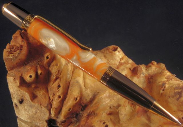

This is an example of one of the only two color mixes that sells for me . I call it Creamsicle .
