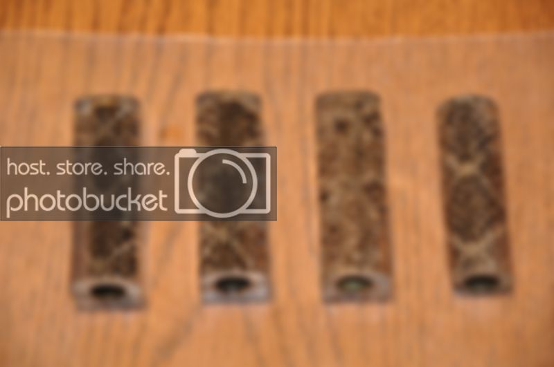

Okay heres a pic. The two on the right are the ones I screwed up and the one the wife dropped. The two on the left just came out of the mold this morning and look good. I'll let them rest a few days before doing anything with them just to be sure!! Thanks for all the help in this process guys!!
A suggestion the one that the wife dropped mite be able to be saved. If it chunked out and didn't tear out the skin it can be recast. Also if it cracked you still mite be able to save it. Use a dremel to open the crack and then carefully pick at the P.R. till you reach the skin. Then recast P.R. adheres to it self very well. Also about post curring I don't use oven to post cure I will preheat the mold just before casting to about 150. I also preheat the resin with hot water to about 110. I use 3 drops no more than 4 drops MEKP. I do put outside after 12 hour set to finish cure in the sun. I would not post cure more than 150 the more you heat it the more brittle it will be.
