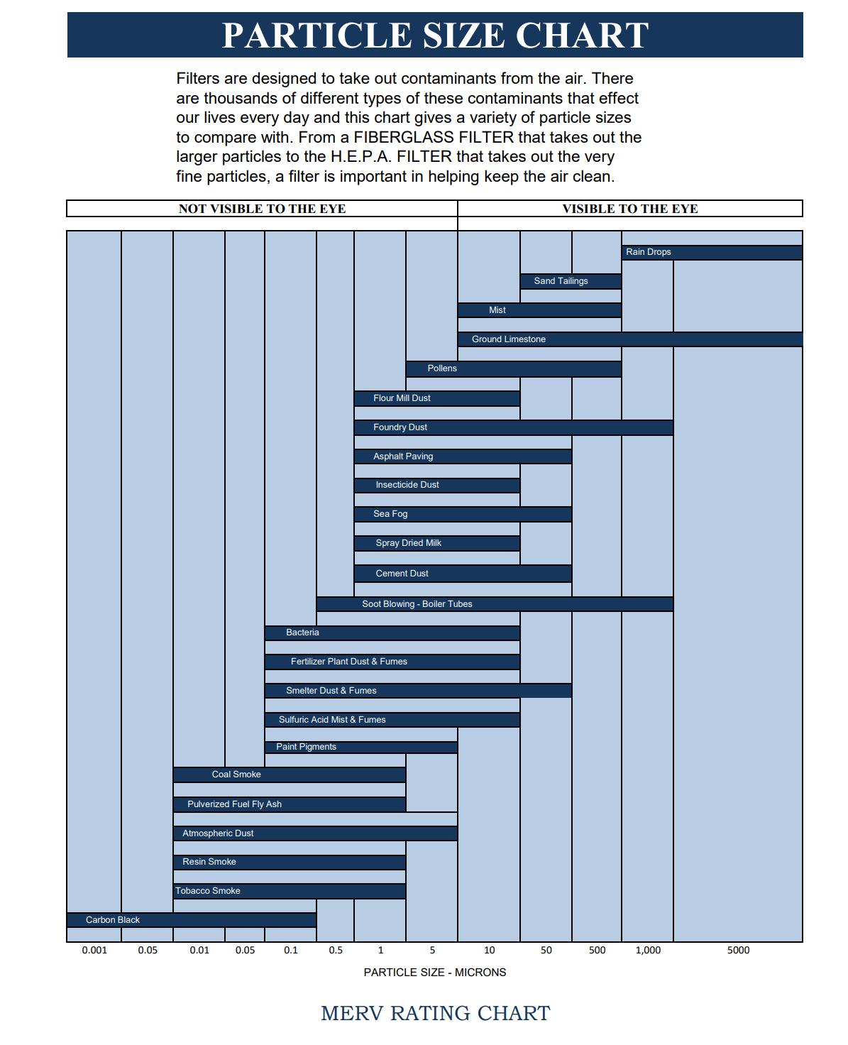

Just to start this, I am not an expert in the field of chemistry or air quality, just someone who does a lot of research on what I do and use, so take my comments as an opinion only.
Your shop vac typically cannot filter out anything below 3-5 microns even with a HEPA filter installed. Most dust collection systems in our shops are designed to filter down to 1-3 microns IF you have opted for the high performance filters. If you are still using the bags the DC came with, you are getting much larger particulates into the exhausting air. Doubtful with either system that you notice dust in the exhaust air coming from the DC, but if you run your DC for a while, you will surely notice some fine dust buildup on your shop table tops and equipment. You couldn't see it, but it is obviously there. The only sure way to get rid of the dust is to exhaust it outside. Organic matter (CA fumes, lacquer or paint vapors, etc) is no different. You might not see it, and if its diluted enough, you probably will not smell it, but its still there. How many hours you stay exposed to the contaminates now becomes more of the factor, as well as the quality of filtering and fit of your PPE.
The below (and attached) chart provides the micron sizing for a lot of different things, including dust and paint vapor. I think it might give you a better view of what is being caught by your DC and what isn't. If you have a DC that captures 3 microns or larger, use that as the base when you look down the chart - you will be surprised by what makes it through the filter media -
Kevin

Don't have a DC, no place for it and can't afford one, and, if I did, no way to vent outside. NJt, thanks for the info an chart.
