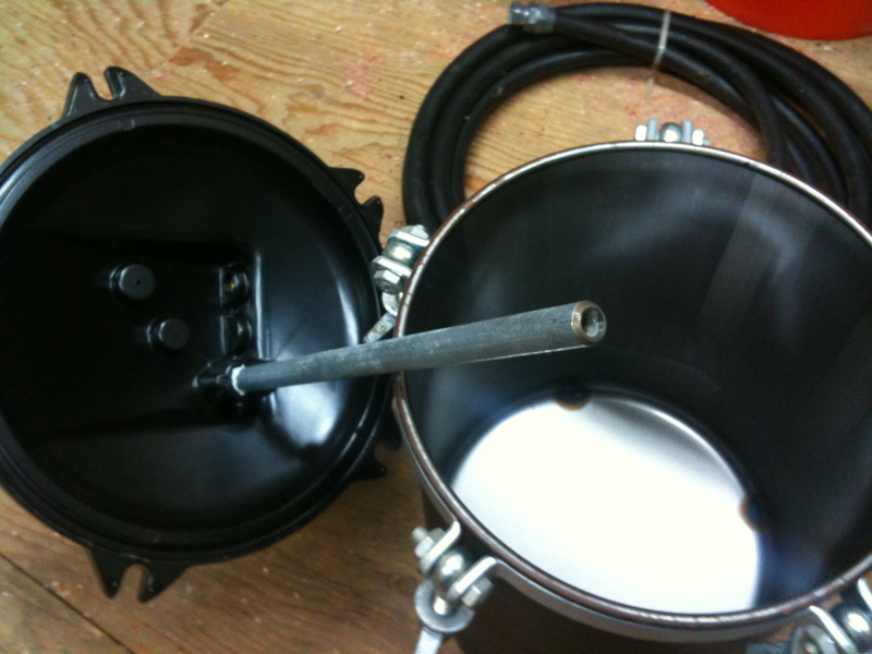

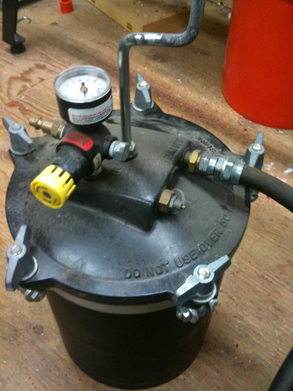

Well I went ahead and got it. It looked brand new and pretty solid. Here are some pics.

Looks pretty solid. I have a Campbell hausfeld that is constructed similarly and have had no problems with it.

This looks like a VERY SOLID tank (and made in the good USA!!!!, I would trust it with my life). I don't think we need more than 40-50psi for casting. My tank is from HF and it was tested by a Machinist friend of mine, the unit started to leak at 120psi. We then set it up back with its 60psi release valve.
