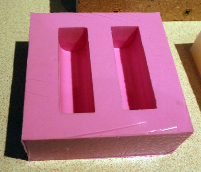

Yeah I read the instructions and it recommended using vacuum but I didn't have any way to do that. So I just gave it a try without that. I applied manual vibration and saw air bubbles rise and pop at the top. Hopefully I can pop it out tonight and see what happened.

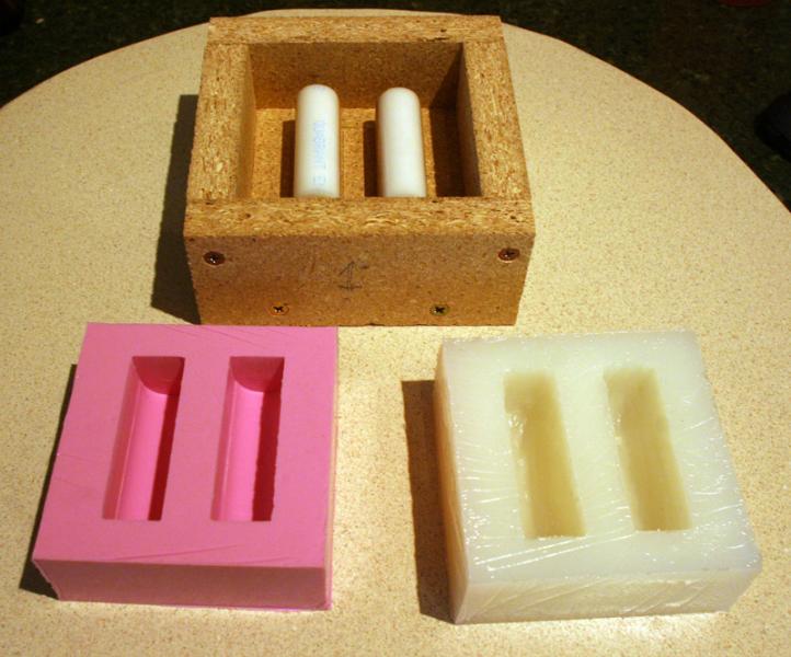

Well the Mold Max mold came out pretty awesome. Doesn't look like there was any need for vacuum because there are no visible air bubbles. I only see wrinkles from the saran wrap. I put the Silicone version in the photo as well...it doesn't look anywhere near as nice.
This is only half the idea...these are basically just 3/4" slots with a 3/4" rounded bottom but some extra room on the top and sides. The second part of this will be machined parts from Delrin that will suspend the tube in the mold. I could make them on the wood lathe but since my metal lathe is arriving next week I'll wait till then so the parts are more precise.

Those look good. I am about to order some too.
I have been reading and watching videos. It seems the amount of air bubbles, like in casting, is directly proportional to how heavy handed the stirring is. Is it possible to mix this with kid gloves or do you really have to put some effort into it?
It's fairly thick stuff but not too hard to stir. I used one of those rubber spatula's like for stirring cake mix. I noticed as I would roll some of the goop over while stirring it was creating air pockets so then I tried to be more careful. I did see small bubbles rising but they would pop without me touching them and so then I shook the mold sideways for about five minutes to help move any other air. I noticed the first 10-15 minutes I still saw new air bubbles rise and dissipate. It seemed like the air does push it's way up through the goop but it's just really slow. So as long as you're mold doesn't have a type of shape that could trap air it's probably ok.
From reading your first post, I expected a disaster! Actually it turned out great. After a few uses, please let us know how its working. I realize your new mold looks nicer than the silicone ones do, but is there any difference in performance?
I have made some silicone molds. That's a great idea about rounding out the bottom of the mold. I will have to give that a try on my next mold.
Well the big difference between using Silicone and Mold Max has more to do with making the mold. The Mold Max cured in 24 hours because it's a two part mix. Maybe if you try some of the suggestions from others to mix the silicone with water and soap first you could speed it up. For my silicone mold I removed the sides of the mold after 2 days to try to get more air to it. Then after 5 days I pulled out the center pieces and it was still mushy in there...I had to try to smooth it out with my finger. That's why my silicone mold looks messy inside. I'm sure it would still work functionally I would just get rougher edges on the blanks. I'm not going to cast with the mold until I make the parts I want to hold the tubes.
