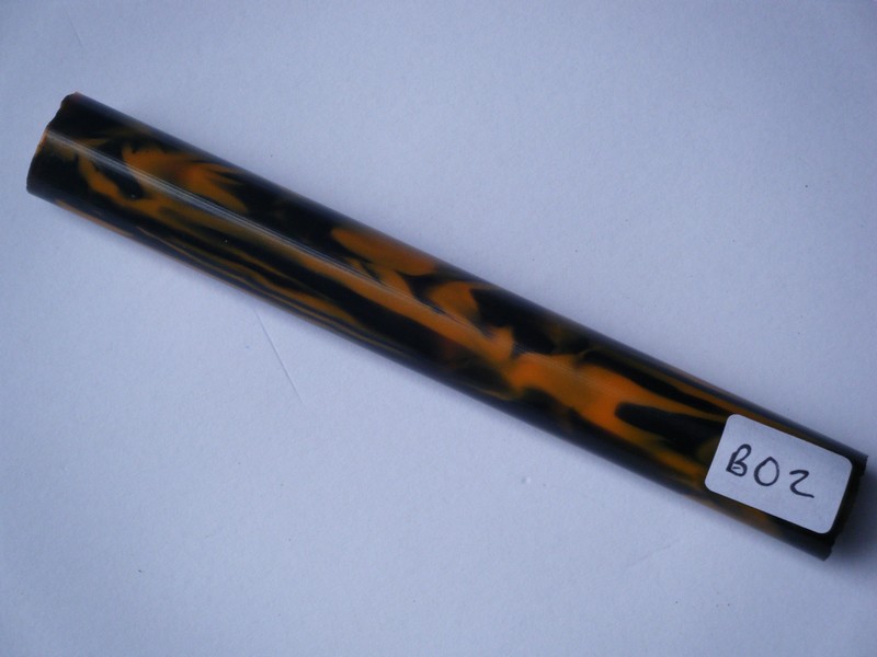

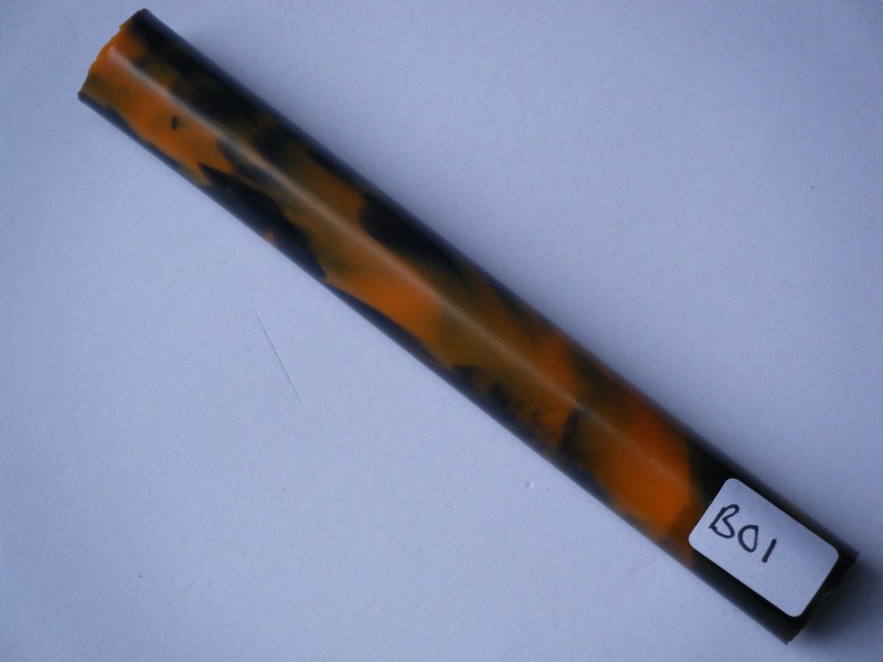

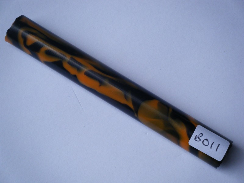

Hi, I didn't seem to have any problems when I did these. They are just opaque colors but I poured them quite quickly. It is just water clear polyester resin that I use. I had concerns about my colors blending but as yet I have not done too badly.
Eric...
