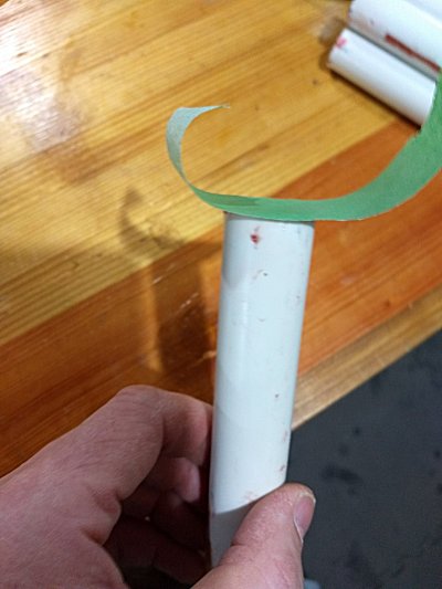

Sure. I use 1.5" painter's tape.
Cross one piece over the bottom:
attachment.php

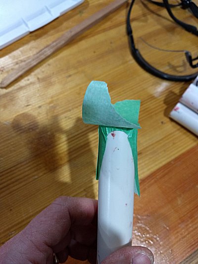

Press and smooth:
attachment.php

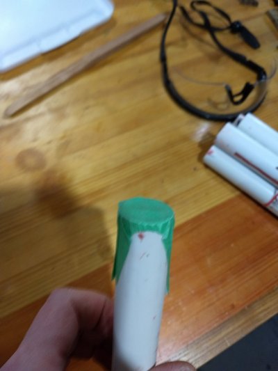

Cross a second piece over the first and smooth:
attachment.php

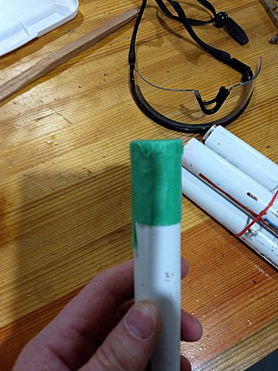

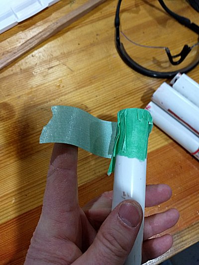

Wrap a third piece around the first two:
attachment.php
Finished and ready for filling:
attachment.php
Whenever I think I can get away without wrapping the third piece around, I regret the decision and end up with a few leaks. There's also a risk of poking a hole in the tape if a piece of wire or something is used to swirl the resin in the mold.
If you're having success with end caps, there probably isn't any reason to stop doing that. Taping the ends takes time, but I'm never in a hurry when I'm casting. I cast for fun, not for profit.

Thanks for the pictures! I decided to try it yesterday and that's the way I went with the tape. No leaks! Good point on the stirring rod. I didn't use one yesterday, but good to have that in mind for next time.
