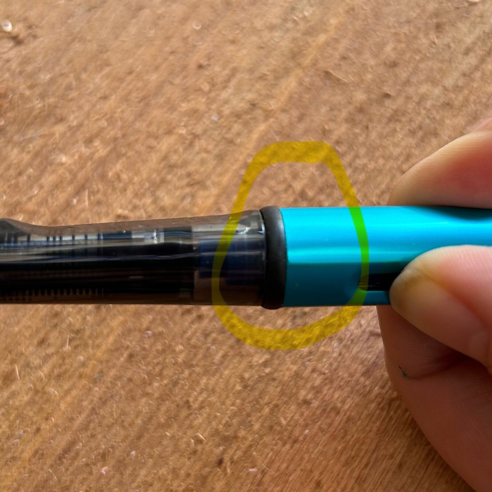

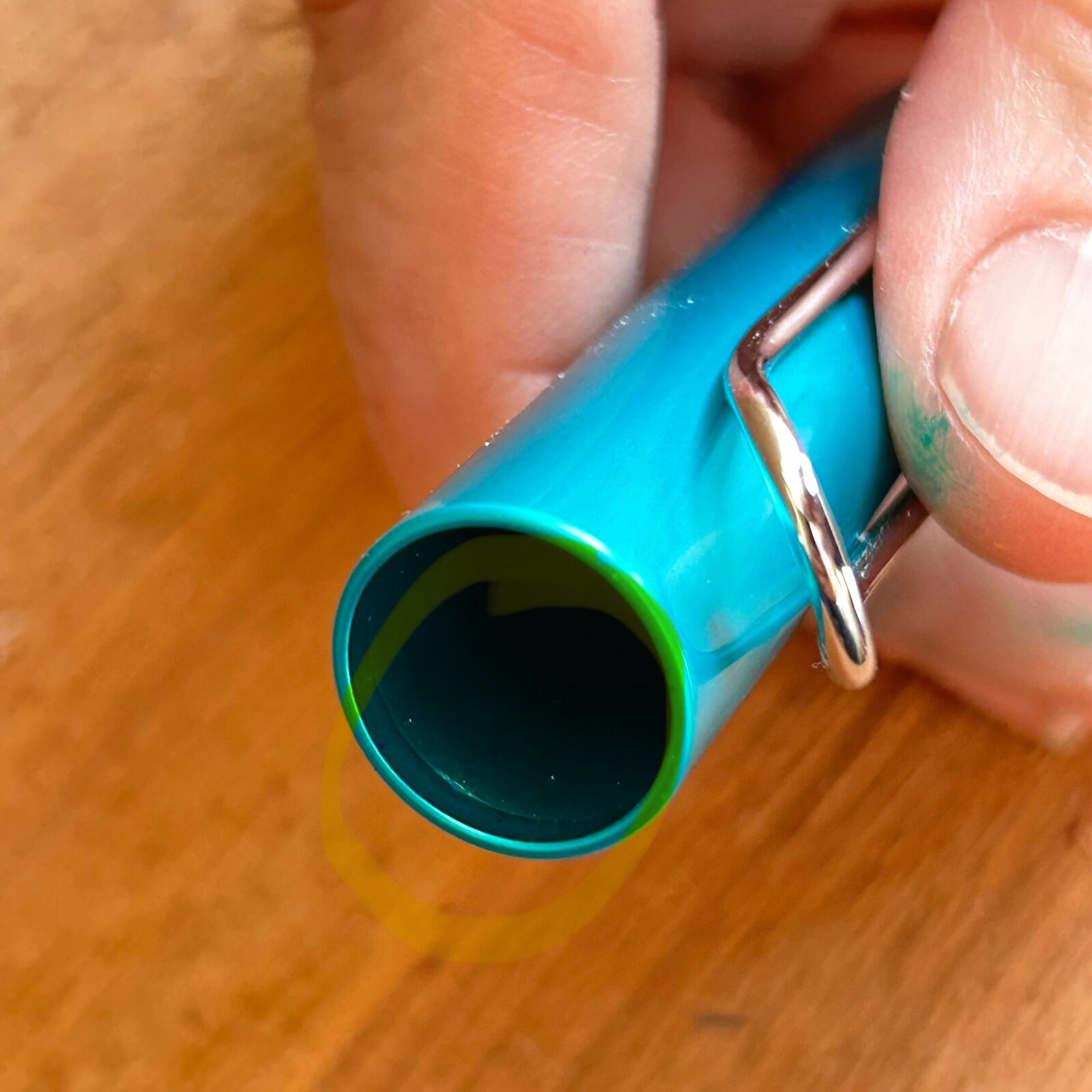

This made me think of my Lamy I bought over the summer, it has a cap that clicks on and off and is postable. I've not seen in in more handcrafted pens though, but maybe it's a thing one could do with CNC.
The photos aren't great hard area to photograph, but basically at the end of the body where the cap fits there's a little bead and inside the cap a small bevel.

This made me think of my Lamy I bought over the summer, it has a cap that clicks on and off and is portable. I've not seen in in more handcrafted pens though, but maybe it's a thing one could do with CNC.
I noticed that as well, it was my LAMY that made me figure it out. Actually, you'll be surprised that it is actually not that part that makes the clicking sound, or holds the pen in place. It is actually the little plastic bump just after the nib. And the second, bigger plastic bump must seal off the ink from drying up. If you take off the midsection so that you're holding just the metal sleeve of the body and the cap, you'll find that you can slide the metal sleeves over each other forever, they do not catch on each other anywhere to make the clicking sound. But, then if you take the nib/section/converter piece that doesn't have the metal sleeve on it anymore, if you put that into the cap, you'll find that the cap secures it, and it might make a faint clicking sound. And then if you put the metal body sleeve back on, you'll find that the clicking noise is somehow amplified. Who knew that a pop cap would be so hard to design
Interesting, I kind of just assumed it was that little bead and bevel inside the cap. I don't really spend long analyzing it.

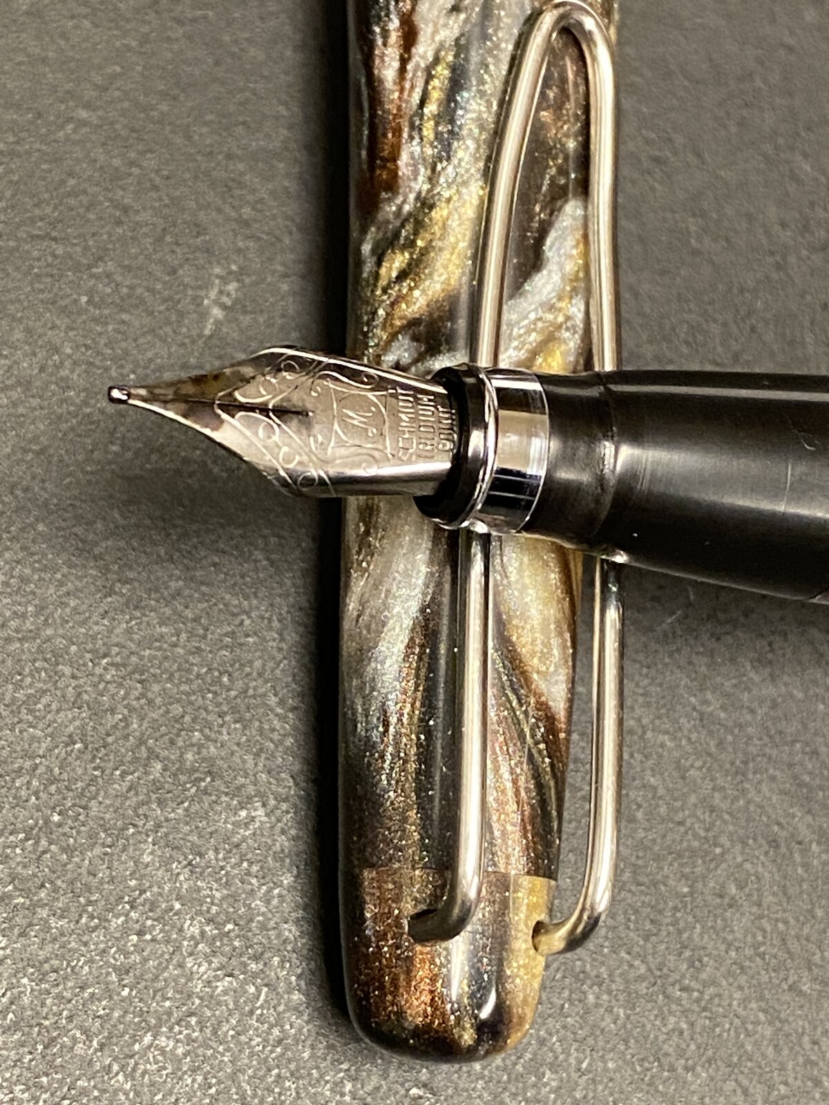

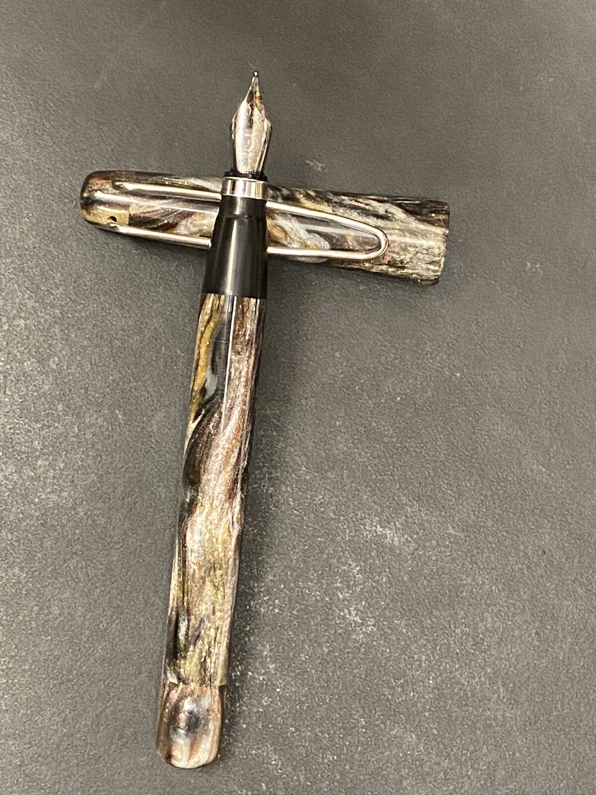

Greetings
I designed and built a snap housing then decided it was easier to buy Schmidt nibs from Milan's Pens and Parts. I made a roller ball pen so I used the snap part and copied the ring geometry from the FP nib onto my roller ball nib. Still works great after several years.
Thank you! That is very reassuring that doing that can work, and in particular that it still works great after several years. I have since come across these, buying the plastic inner cap part and then making a custom section with the copied ring geometry is something I'll experiment with as well. I just don't like how on the stock nib there's such a large black section by the nib, or how thick the metal band is.
Yeah, I'm not a fan and wouldn't use them if I were selling pens but for my novice pens and experiments the price is right. Here is a pen with the nib and the snap cap. The snap cap is held in place with a set screw. There is an adjustment tool available that works better than a screwdriver,IMO.

Oh, that's cool! Thank you!
