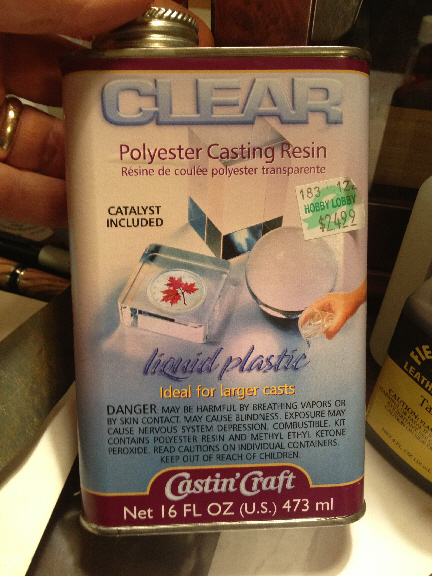

OK, I decided to try my hand at blank making. I bought some of this stuff at Hobby Lobby:
How much of the catalyst do I need for two ounces? The chart on the container doesn't make much sense to me as the thicker the layer the less catalyst you use. Seems like it should be the other way around.
I used 8 drops of catalyst per ounce (so 16 drops). It seems like its taking for ever to get to that "gel" state.
I started with that resin and have since changed to silmar 41. If I remember correctly I used 10-12 drops per ounce and it still takes a while before it gels. But once it starts to gel you have very little time before you have to leave it alone. Maybe with less activator you will have more time to play in the gel state. Temp and humidity play a role in resin casting also but there ar plenty of threads to read up on that!
As I was typing my question, it decided to gel up on me. Right after I added some color to swirl in. Another screwed up blank. Oh well, it's only my second attempt. Live and learn as they say. Thanks for the info.

The chart is right. The thicker your pour, the more heat it will hold.
Generate too much heat and you will get a brittle blank, or perhaps it
will crack on you before you turn it.
I generally run about 3-5 drop per ounce.. maybe a little more if the
catalyst is getting old.
I try to avoid getting resin at the craft stores if possible. Their staff
aren't generally familiar with casting, so they don't really understand how
critical "stock rotation" is. They'll put the new stuff in front of the old,
and it could sit there for quite some time. Old catalyst seems to take
longer to kick and makes your results a bit less predictable.
I know Cast'n Craft does have a date code on the bottom of the can,
but I don't think the catalyst does.

Where can I get that Silmar 41 and some catalyst for it to boot? Is it cheaper than the Castin' Craft? That was $25 for 16 oz.
