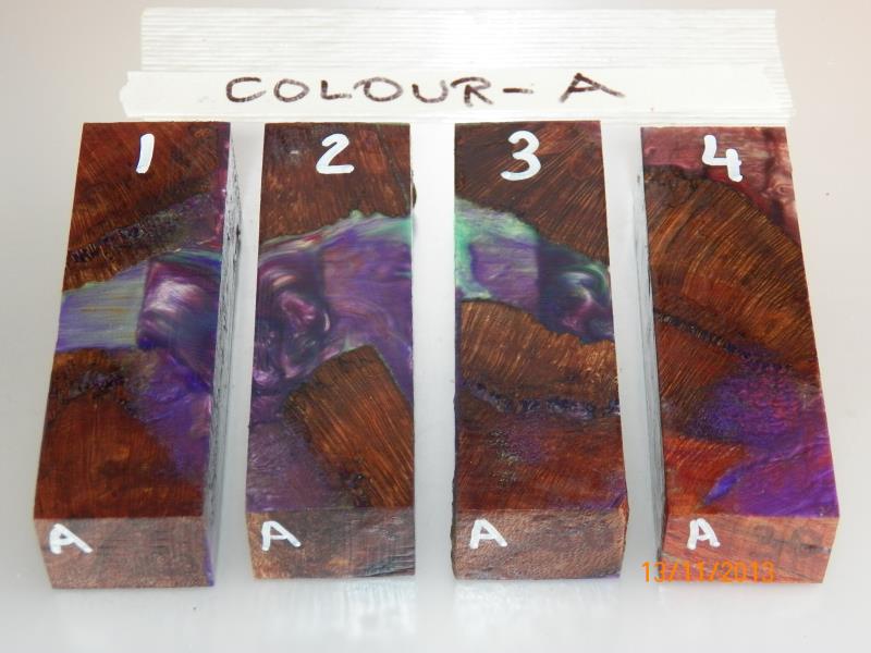

How it looks like...??? well, I just done a few knife handle blanks to go to Russia, made with Bottle Brush stabilized root with 2 ends and the resin in the middle, as requested. This was a 3 colour mix and the effects are made using the vacuum chamber for about 1 minute (reach full vacuum) and them put in a pressure pot at 80 to 100PSI...!
The effects inside are absolutely stunning, one of the blanks was requested to be sliced in half as 2 booked matched scales, unfortunately I don't have any pics of that, as I sliced the blanks just before I packed the box with all the blanks ordered and I forgot to take so pics, I only though of it the next day when I downloaded the pics I had in my camera...!
Anyway, I've got a pic with this batch, one of 6 batches, all with different woods colours and effects, only this one was done with the vacuum chamber,
