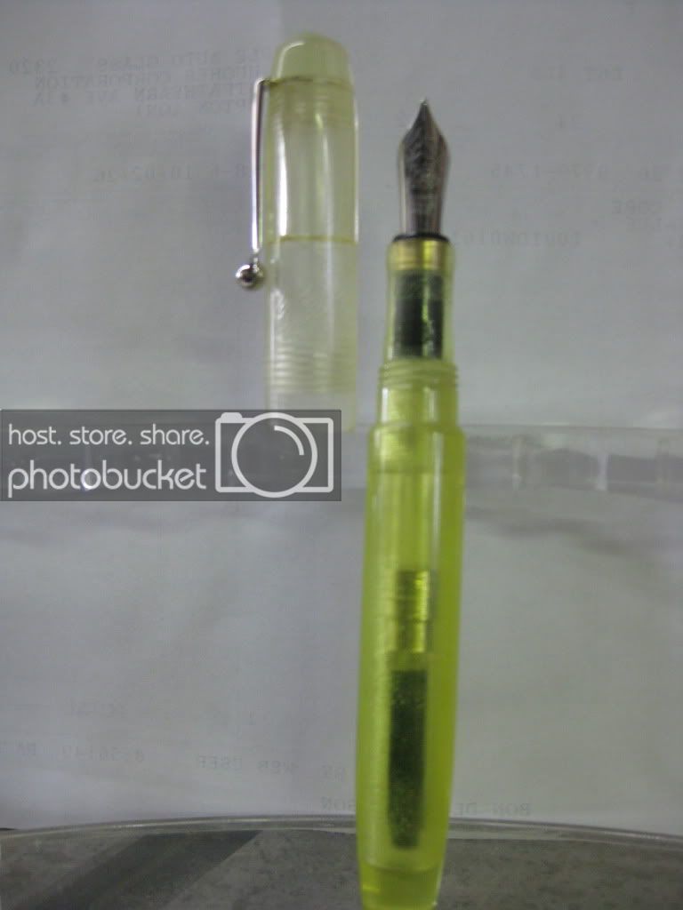

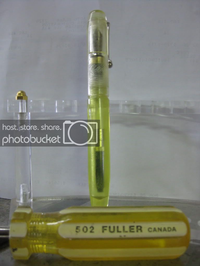

I had some old screw drivers laying around so I thought I would see about making a see through pen.
I tried different speeds, working my way up to size, acid bath, felt wheel inside and none that I was 100% pleased with and I am wondering in anyone else has any good ideas.
