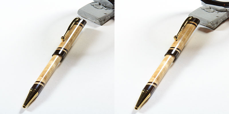

Whew! That's a lot to get through. What's important to realize though is that glare can be be either polarized or unpolarized. If your light source is unpolarized, then glare off metal pen components will be unpolarized. Glare off a wood or plastic pen barrel, however, might be.
If the glare is polarized, then a polarizing filter can reduce or remove it. If the glare is unpolarized, however, then a polarizing filter will not. If the glare is mixed, then a polarizing filter could reduce it on one part but not another.
So, although a single polarizing filter on your camera lens might help control some glare, it is not a complete solution.
There is a technique called cross-polarization that some people use. In this setup, you place a polarizing filter over your light source. The diffuse reflections off your subject are depolarized. The direct reflections off your subject are polarized - even if they are metal. Now, a polarizing lens filter will remove the direct reflection (glare). Cross-polarization can work quite well, but it does have its own limitations. First off, it typically limits you to one light source (matching polarization can be difficult). Secondly, the polarizing filter halves your light, so to achieve the same exposure, you'll need a brighter (more expensive) light. The filter itself is an additional investment as well. Finally, some subjects will repolarize the direct reflection in multiple orientations, so there are still situations that cross-polarization will not handle.
Fortunately, there are tools to manage glare besides polarization. Since glare is really a matter of direct reflection - not polarization - then glare (polarized or unpolarized) can be controlled by manipulating the direct reflection. The angle (or "family of angles") of illumination that produces direct reflection is generally small compared to the angles that produce diffuse reflection. Therefore, you can control the glare by adjusting the relative brightness of the light(s) within that family of angles. If you want to reduce glare, you can selectively lower the proportion of light coming from the direction that produces direct reflection. Product photographers often use multiple lights and/or reflectors outside the family of angles of direct reflection, or place a "go-between" (a.k.a. "gobo") in front of a light blocking the family of angles that reduce glare.

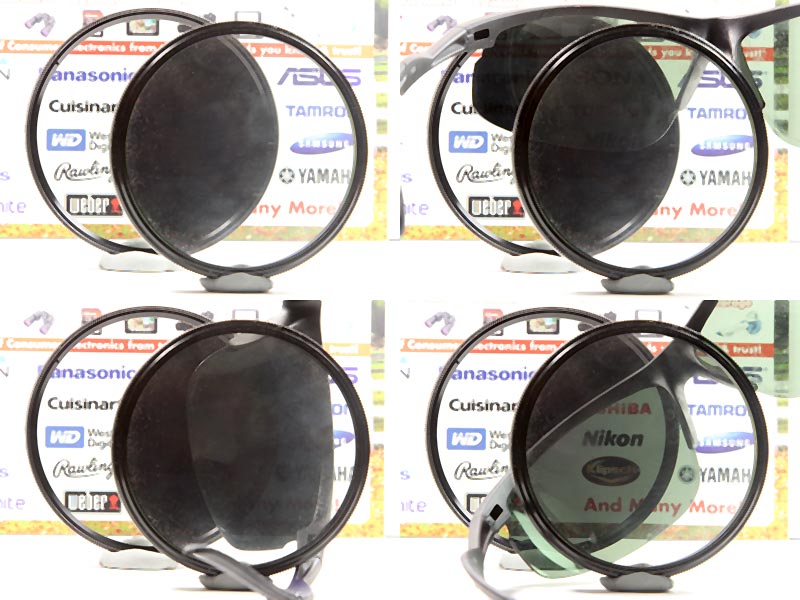

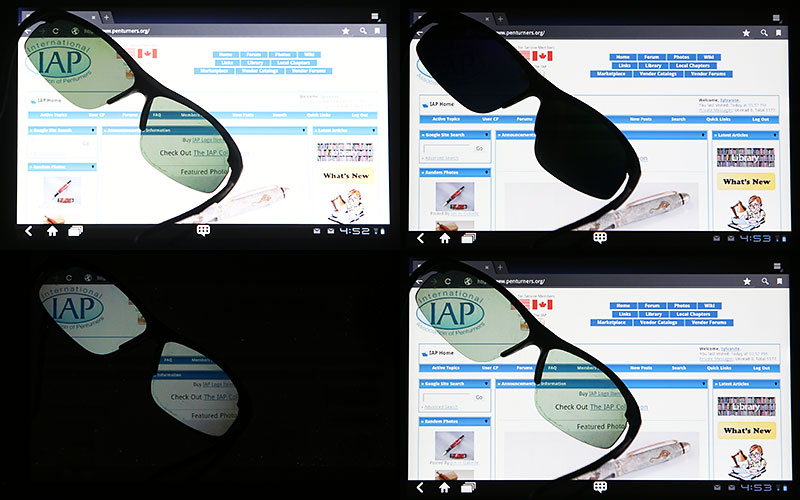

How to tell if a light source is polarized
Here's an experiment you can perform to tell whether or not a light source is polarized:
  1. Set your camera to full manual exposure mode and mount a polarizing filter on the lens.
  2. Turn your source light on and place a linear polarizing filter (such as a pair of polarizing sunglasses) so that it partially obscures the light.
  3. Take a series of 4 photographs (all using the same exposure settings), rotating the camera's polarizing filter roughly 45 degrees each time.
If the light source is polarized, then you will see the image change in brightness noticeably - from white, to gray, to black, and back to gray (although not necessarily in that order).
If the light source is not polarized, it will be equally bright in all 4 photos.
The polarizing filter (sunglasses) serves as a control for the experiment. That part of the image will be polarized (whether the source is or not). You should see it change in intensity as you rotate the camera's polarizing filter.

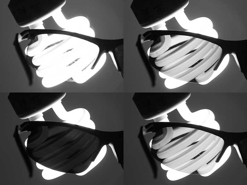

Proof that a CFL light bulb produces unpolarized light
I performed the above experiment with one of the CFL bulbs I use for pen photography. This is how the images changed as I rotated the camera's polarizing filter:
attachment.php
You can clearly see that the polarizing sunglasses changed in intensity dramatically. That part of the picture had polarized light. The rest of the light bulb, however, is bright in all 4 photos. The light bulb itself produces light that is NOT polarized.

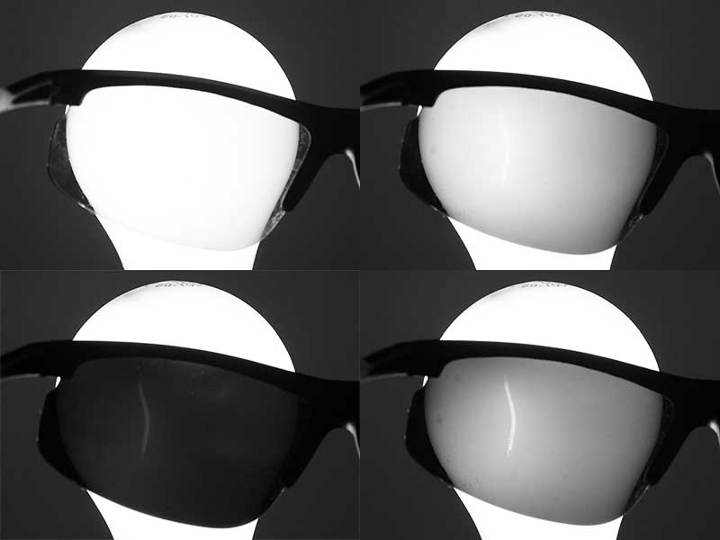

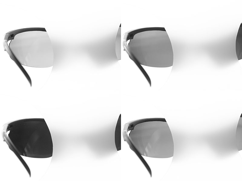

Proof that an incandescent light bulb produces unpolarized light
I performed the above experiment again, with an ordinary household incandescent light bulb. This image shows how the photographs changed as I rotated the polarizing filter:
attachment.php
As with the CFL test, the sunglasses indicate the effect a polarized light would produce. The bulb intensity, however, does not change. Therefore the light produced by the incandescent bulb is NOT polarized.

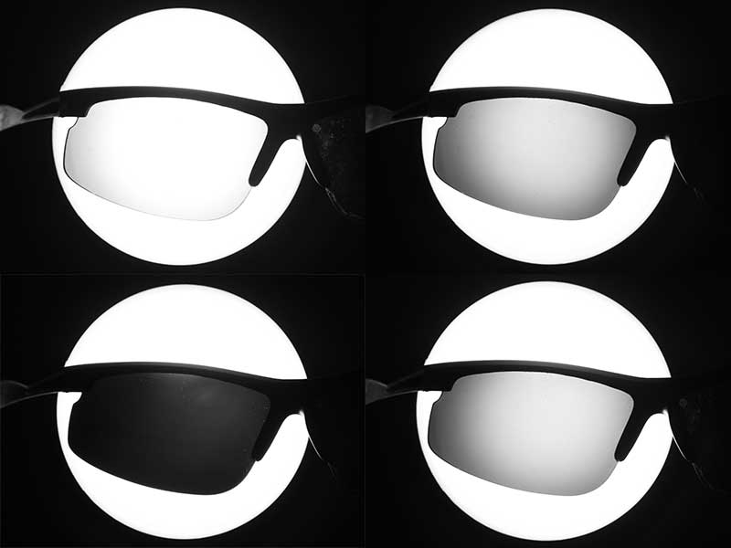

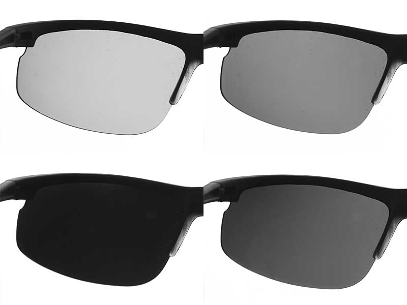

To round things out, I tried again, this time with a household LED flood light. Here is the result:
attachment.php
Just as with the previous two experiments, the polarizing lens darkened as I rotated the camera's polarizing filter, but the bulb itself did not. The light given off by the LED bulb is NOT polarized.
attachment.php

Not true. The experiment photos above demonstrate that the light emitted from the bulbs (no matter how much they were reflected internally) is not polarized. Many (most) light sources "known to man" are NOT polarized.

Some light sources ARE polarized
I've shown three light sources (fluorescent, incandescent, and LED) that produce unpolarized light. Now here's one that is polarized:
attachment.php
This is the LCD screen on a tablet. Note that as the cameras polarizing filter (CPL in this case) is rotated, that the screen brightness changes as well as the brightness as seen through the polarizing sunglasses. That demonstrates that the light emitted by the LCD display is linearly polarized.
Now, we don't often use LCD lighting for pen photos, but people have posted pen photos taken on a LCD background. See http://www.penturners.org/forum/f24/unusual-small-item-photography-setup-94007/ for an example. If one tried to use a CPL filter to control glare on a pen sitting on such a background, unexpected results might occur.
Note, not all LCD displays exhibit this phenomenon. My LCD TV, for example, does not. I believe that's because it incorporates a form of quarter-wave plate over the LCD layer. That changes the linear polarization to helical (or "circular") polarization (just like a CPL filter does for a camera - although for a different purpose).

Proof that polarizing sunglasses are a Linear Polarizing Filter
I set up the following 4 photos (combined into one image) to demonstrate that the pair of polarizing sunglasses that I'm using is indeed a linear polarizing filter:
attachment.php
Image 1, in the upper left corner:
In this photograph, I've arranged two photographic linear polarizing filters with a little bit of space between them. The rear one is turned to block light that is vertically polarized. The front one is turned to block light that is horizontally polarized. Where they overlap, they block all light. The card behind them is lit with unpolarized light.​
Image 2, in the upper right corner:
Here, I've place the polarizing sunglasses in between the two photo filters, oriented horizontally. You can see that this matches the polarizing angle of the front filter. Where it overlaps the rear filter, the image is black.​
Image 3, in the lower left corner:
In this photo, the sunglasses are between the photo filters, but oriented vertically. This matches the polarizing angle of the rear filter. Where it overlaps the front filter, the image is black.​
Image 4, in the lower right corner:
And, finally, I've oriented the sunglasses (still between the photo filters) at an angle. Now it does not match the polarizing angle of either filter. The area where it overlaps both filters is now transparent (although dark). You can read the ad (where it says "Nikon") that was blacked out in photos 1-3. This effect may seem counter-intuitive (after all, how is it possible that an additional filter could unblock light?), but it is real. The rear filter converts unpolarized light into vertically polarized light (dimming it in the process). The middle filter (the sunglasses) converts the vertically polarized light into light polarized at a 45 degree angle, and dims it further. The front filter converts the 45 degree polarized light into horizontally polarized light (and dims it yet again). Although each filter reduces the amount of light transmitted, some does indeed get through.​
A non-polarizing neutral density filter will not produce the above results. It won't totally black out areas overlapped with a single polarizer like photos 2 and 3 do. A circular polarizing filter will not produce the above results. It will undo the linear polarization of one of the two outside filters (which one depends on which way the CPL is facing), yielding a result that is the same as using just 2 linear polarizing filters. Quarter-wave plates can be combined to rotate polarized light by 90 degrees, but not 45 degrees as the sunglasses did in photo 4.
Only a linear polarizing filter will produce the effects shown above. Therefore, the sunglasses' lenses are true linear polarizing filters. They aren't "made for photography", but they work exactly the same way as a photographic linear polarizing filter does.
If you happen to have 3 photographic linear polarizing filters, or 2 CPL filters and one PL (you just have to put the CPLs on the outside and face-to-face), or 3 pieces of linear polarizing film, you can easily perform this experiment for yourself.
I hope that helps,
Eric

Proof that a light tent does not polarize light.
Ok, enough about the polarity of various light sources. It has been said that diffusion of light polarizes it; that simply passing through a light tent will polarize light. Here's a set of photographs showing that it isn't so:
attachment.php
The above 4 images show an illuminated light tent wall photographed through a circular polarizing (CPL) filter rotated in (roughly) 45 degree increments. Each one was taken with the same exposure. You can plainly see that the tent wall (the white background) luminosity remains constant.
If the diffuser (tent wall) had polarized the light, then it would have darkened to black, just like the polarizing sunglasses lens did (in the photo in the lower left corner). The angle of the CPL, howevver, made no difference. Therefore, diffusion in general, and a light tent wall in specific, does NOT polarize light.
Proof that a light tent actually depolarizes light.
I've claimed in the past that not only does diffusion not polarize light, that in actually de-polarizes it. Here is an image to support that assertion. I placed a linear polarizing filter (polarizing sunglasses again) immediately behind my light tent wall, through a pair of openings in the front.
attachment.php
As before, these four photos were shot at the same exposure with a circular polarizing (CPL) filter on the camera lens rotated in approximately 45 degree increments. You can see that as I changed the polarization axis of the filter, the exposed part of the sunglasses turned dark - all the way to black. The covered areas, however, did not change in intensity. There is a shadow showing, but it is pretty constant in all 4 pictures. If the light tent wall passed light without affecting polarity, then the area covering the sunglasses would have turned black along with the unobscured lens (lower left photo). If the tent wall had changed the polarity, then one of the other 3 photos would have turned black (or at least much, much darker). They didn't.
Because the light striking the inside of the tent wall was polarized (by the sunglasses), but the light exiting from the tent wall was not, I conclude that the light tent (via diffusion) depolarized the light.

Direct sunlight is not polarized. Here's a simple experiment you can perform in a spare moment to demonstrate that:
Take a piece (it doesn't have to be very big) of your photographic linear polarizing film outside on a sunny day and hold it such that you can see its shadow. Now rotate it slowly through 180 degrees. If the sunlight is polarized, you'll see the shadow disappear completely when the film's axis of polarization aligns with the sun's polarization, and the shadow will darken to black when the film's axis is perpendicular to the sunlight's. If the shadow does not lighten and darken as you rotate the film, then the sunlight does not have an axis of polarization - and therefore is not polarized.
Don't just read about it. Try it for yourself.
I did it just now with a photographic polarizing filter. As I rotated the filter, the shadow stayed the same shade of gray.

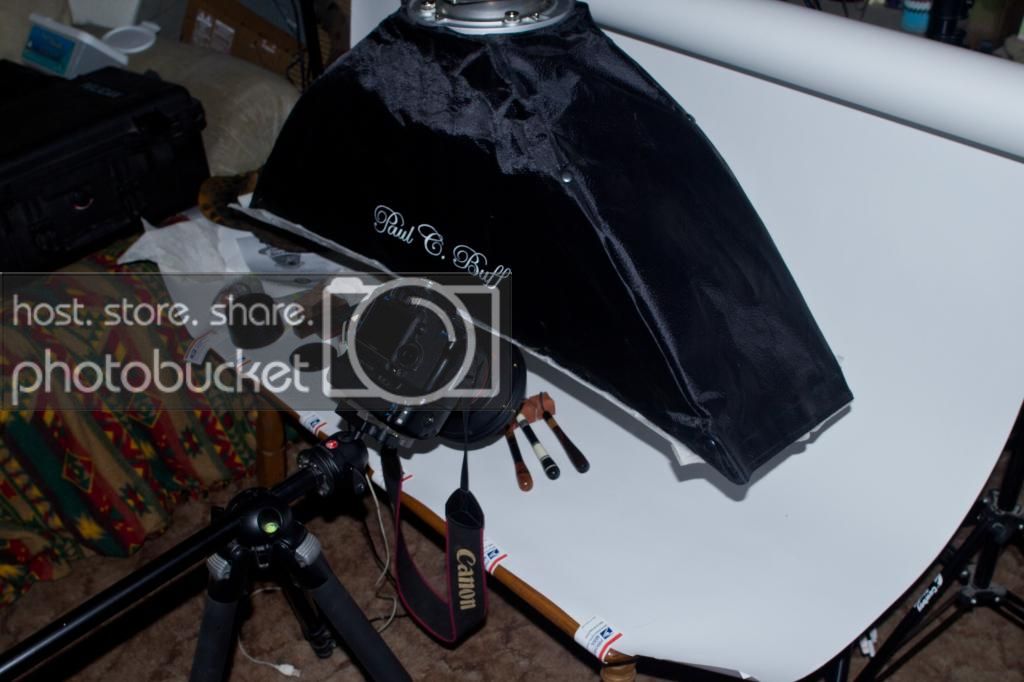

Regardless if the light source is polarized or un polarized I have soft boxes on my strobes, < Polarization by Reflection > I soften my light, the light that is going through my soft boxes is being polarized because its being reflected and scattered ...Polarization by Scattering.
Then the light is filtered Polarization by Transmission which is really is separating the light.
The word polarize means to separate!, therefor the light that strikes the pen is polarized light.......................................
Ok.

  1. Can you take a photograph demonstrating that your softbox emits polarized light?
  2. Can you explain why none of the photos in POST 20 - "Proof that a light tent does not polarize light" darkened if diffusion polarizes light?
I challenge you to do so.

  1. Did you perform the experiment I described in POST 30? If not, please do. If so, did the shadow disappear (lighten) and darken as you rotated the film? If not, explain why not.

1#Did you perform the experiment I described in POST 30? If not, please do. If so, did the shadow disappear (lighten) and darken as you rotated the film? If not, explain why not.
Answer
No, I don't trust your experiments and I am not photographing sun glasses in a test when the lenses in sunglasses are not just linear polarized film, there is another thin film that goes over the linear polarized film used in sunglasses just for humans. This why I offered you Linear polarized film LPF used in photography, I said in the beginning I wanted to use LPF that was used in product photography and production sets like TV .
SEE 3D Movie glasses and sun glasses design.

Putting Linear polarized film (LPF) over my soft boxes is the only place you can place it to get a cross polarization.
If I put the film inside the soft box the defuse panel ( white cloth ) over it.
It would create polarized waves to travel at more then just a linear motion.
Answer
Well, you've made it abundantly clear that you object to polarizing sunglasses (even though I demonstrated that they are linear polarizing filters exactly like those used in photography (which are by the way, different than 3D polarizing glasses). That is why I:
  1. performed the test you reference above with a photographic linear polarizing filter, and
  2. asked you to perform the experiment with your linear polarizing film
If you still refuse to try it out for yourself, then go ahead and send me some film. I'll repeat some experiments using it on one condition: that you agree to accept the results.

As I said above, sometimes direct reflection will polarize light. If unpolarized light strikes a non-conductive surface at the correct angle, then the surface can absorb the portion of the light with an axis of polarization perpendicular to its own static charge, and reflect only light with a polarization orientation parallel to the surface charge. This is what we call a polarized reflection.
Here are a couple of pen photographs exhibiting a polarized reflection. I deliberately placed the pen and one of the lights to produce a glare line that is polarized. I put a polarizing filter (CPL) on the camera lens. Both images are lit the same. The only difference is the angle at which the polarizing filter was rotated.
attachment.php
In the left photo, the polarizing filter was rotated parallel to the axis of polarization of the glare. Because they are aligned, the filter transmitted the glare undimmed. The human eye does not discriminate on polarization, so this is how the pen looked in person.
In the right photo, I rotated the CPL filter 90 degrees. Now it's polarization axis is perpendicular to that of the glare. As a result, the filter absorbed all that light - effectively removing almost all of the glare.
In both photos, the diffuse reflection off the wood, and the direct reflection off the metal components are unpolarized. Turning the polarizing filter from one orientation to the other did not change the intensity of those reflections.
I hope that makes sense so far,
Eric

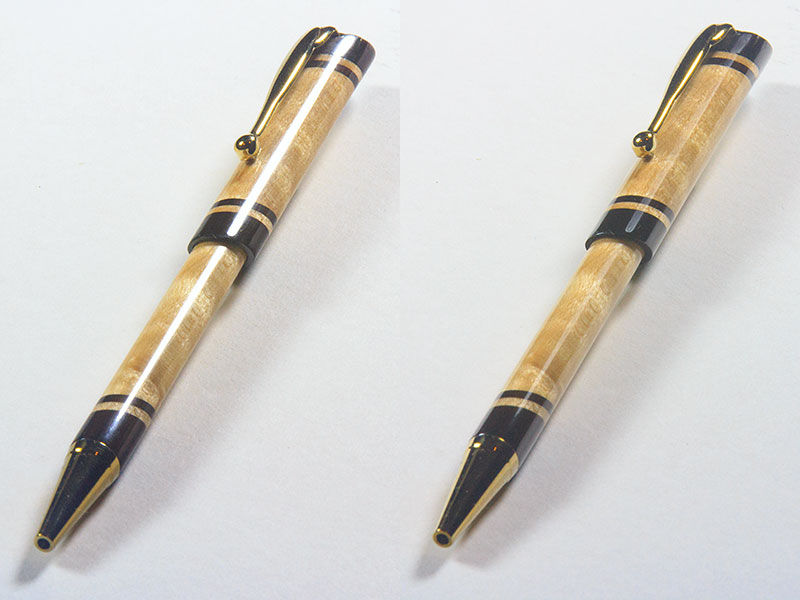

Polarized glare, part 2
A lesser known, less intuitive, but equally effective (if somewhat more expensive) technique is to polarize the light before it hits the pen, rather than after it reflects off. In both of the photos below, I've placed a photographic linear polarizing filter in between the light and the pen (instead of on the camera lens). You can see it in the upper right corner in each image (and its shadow over the top half of the upper barrel of the pen).
attachment.php
In the picture on the left, I positioned the filter so that its polarizing axis matches that of the glare. Other than cutting the amount of light reaching the pen barrel, it has little effect.
In the picture on the right, I rotated the filter 90 degrees, so that its axis of polarization is perpendicular to the polarization of the glare. Just like in my previous post, you can see that the glare in the shadow of the filter has been nearly eliminated.
How does this work? Well the explanation is very similar to that of a polarizing filter on the lens. When light strikes the pen barrel at this angle, the portion that is polarized parallel to the surface static charge is reflected (direct reflection) unchanged. The component with perpendicular polarization is absorbed. In the left photo, I pre-polarized the light so that there is no light polarized in the direction the surface absorbs. Therefore, the filter does nothing. In the right photo, the light is pre-polarized such that there is no light polarized in the axis that gets reflected. There is no direct reflection because all the light was polarized in the orientation that got absorbed.
The wood of the pen barrel produces diffuse reflection, which depolarizes the light. It remains visible whether or not the source light was polarized.
The reflections in the clip are also unchanged. That is because the clip is metallic (conductive). The direct reflection off the clip neither depolarizes nor repolarizes the source light. In the above two photos, the clip reflections are polarized in perpendicular directions, but that polarization is not visible in the photo because there was no polarizing filter on the camera lens. Just like the human eye, the camera's sensor does not discern light's polarity.
I used a small circular polarizing filter in this illustration. To use this technique effectively in studio photography, one would need a polarizing filter large enough to cover the entire light. Photo-grade polarizing film is available in sheets of suitable size, but they are more expensive than a typical lens filter.
I hope that was interesting,
Eric
