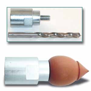

i am looking for this style of mandrel and sells sierra kits. can not find one that sells both.
If you have a drill chuck you do not need a special chuck for bottle stoppers. Simply cut the head off of a 3/8" bolt, use a couple of nuts for your stop, add a piece of scrap wood prior to screwing on the blank and you are off and running.
If you are wanting to get a drill chuck, check eBay. I got a 1/2" MT#1 Craftsman for a little under $20 shipped.
