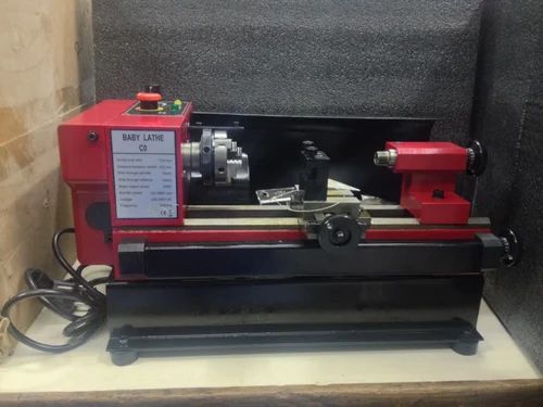

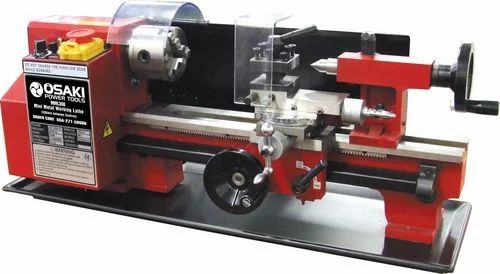

Welcome to the forum.
Because you mentioned that you are interested in making kit pens I would suggest you look into a small metal lathe. You are using them now and many kitless makers use them. Most of the ones sold here are made by one company in China, Sieg. India makes a lot of manual metal lathes and they also make or at least rebrand the Sieg lathes. I think you should consider one and see if there are any sellers/manufacturers in Sri Lanka, shipping would be less for you. I don't know if importing from India would be any cheaper than from China. Some examples I found. Not sure how the exchanges work out so I don't know if they are even close to your budget. Wood lathes made in India might be an option to you too if you prefer one over a metal lathe.
Searches of past threads will give you an idea of what to look for in sizes (swing and bed length) and details like plastic verses metal gearing.
I second what Pete said even though he meant to say Kitless pens is your interest from your post. I am not the person to suggest metal lathes but it would be more accurate for many of the functions needed to make kitless style pens, not that they can not be done on a good quality wood lathe. Good luck in your quest.
