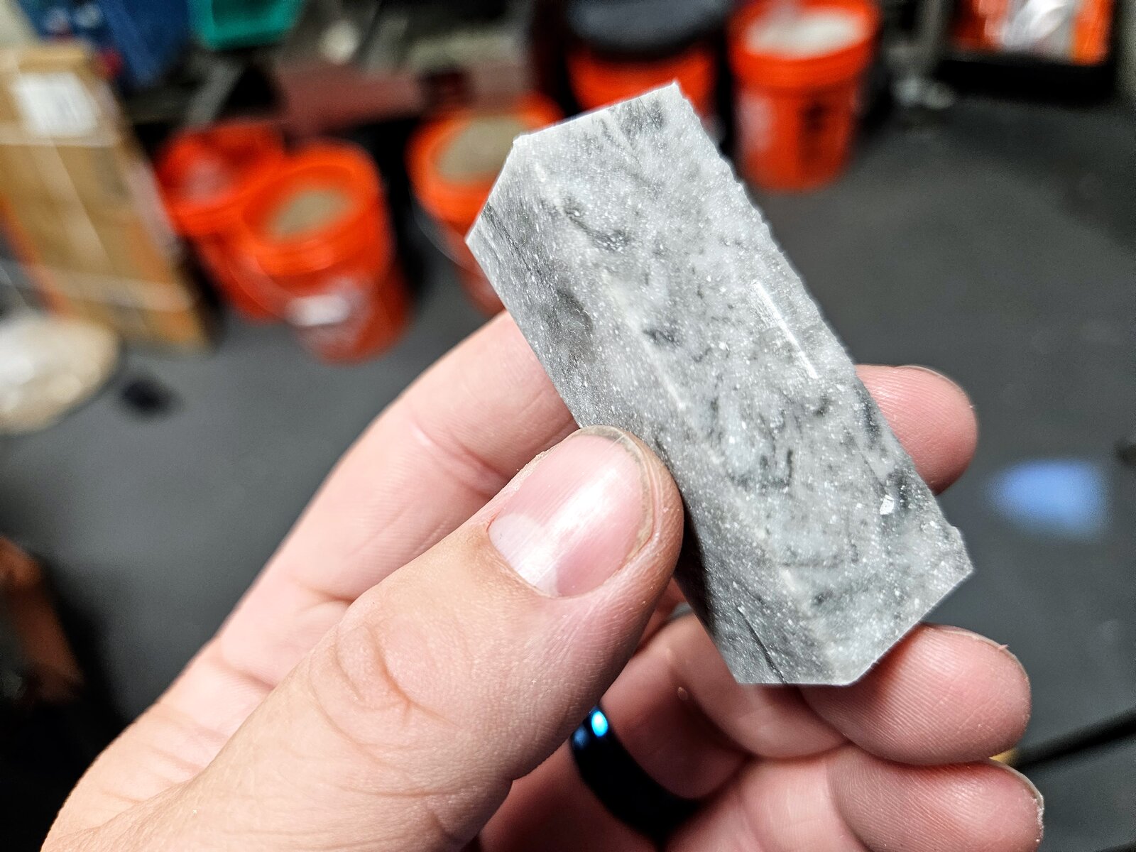

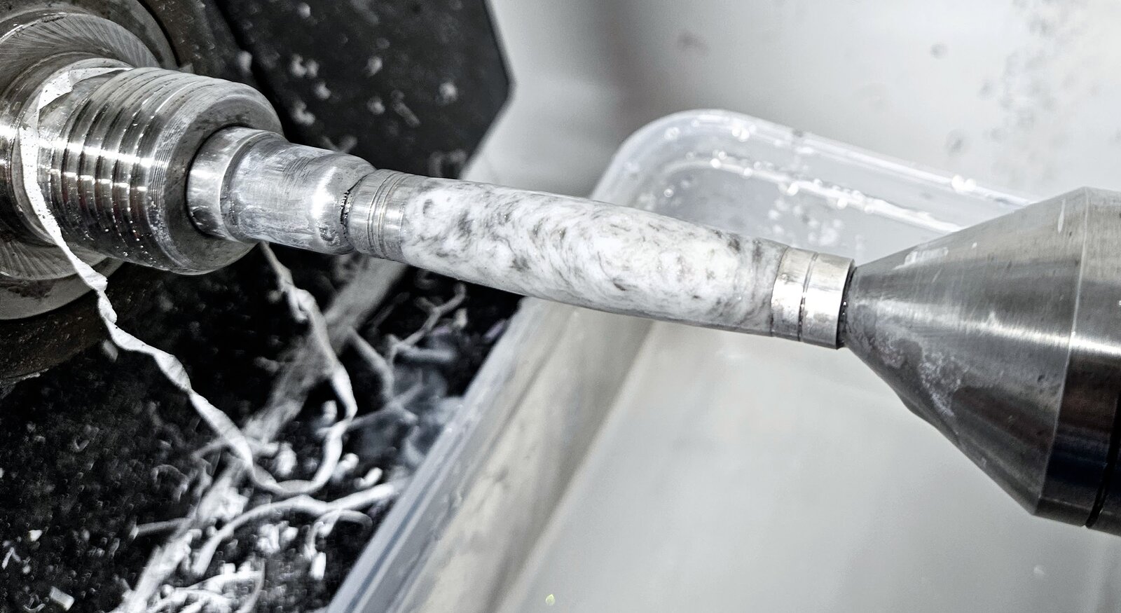

With M3 finally back on the market, I decided to take a minute and see if all the lessons we've learned over the past couple months could be applied to stone. Having turned a lot of the faux stone in the past, I had pretty much the same complaints about it that I did with original M3. Basically, I dislike polyester as a resin base.
So... we took our new urethane and some marble powder and went to work. I think we found a really nice ratio where the blank is primarily stone, and feels like it. The urethane base polishes great, but it's stronger and won't crack nearly as easily. Plus, it doesn't stink when you turn it. (Big win there if you ask me!)
We're going to play with some other ideas as well but for the very first try, this Phony Stone marble came out great. I'm offering up blanks in this month's subscription box on our website if anyone wants to play with it. I will say that I think I really like how they feel just wet sanded to maybe 1500 grit. You can polish it smooth but having just a little bit of texture really helps sell the marble look and feel.
You can see the imperfections in the coloring, etc from the natural stone powder. Those are NOT bubbles, just the variation in the stone.
