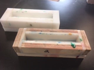

yes - I built mine from HDPE and i like the results. Several versions. First was layering HDPE on some plywood substrate (because I had the 1/4" HDPE handy. After that was successful, I bought 3/4" and made the next batch (which I also like). I use a release agent and haven't had issues getting the blanks out. One thing - I screw the molds together so it's important to label the sides so they go back together to prevent leaks, etc.
If I redo them in the future, I'll make them a little deeper than 3/4". The resin seems to shrink as it cures. Not a big issue but if I'm pouring over wood or something else, I don't like it sticking up after the resin cures.
