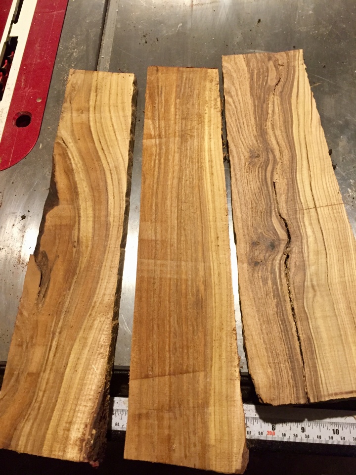

Probably a long shot but was wondering if anyone has ever run a stabilized board thru a thickness planer. I managed to pick up some hard-to-find plum wood that I sawed into around 6 dozen boards about about 5-6" wide by 15" or so long. Then placed them in a vat of DA for a few months. Pulled them out and stickered them till dry. The issue is over half of the boards have splitting to some degree which plum is supposedly prone to. My idea is to dry these in an oven in a jig to hold them to the same dimensions as much as possible and then stabilize them. I don't see any problems overall but I'll have to joint and plane them for what I want to do. Anybody done this or have any insight?
Thanks.
The pic is of a few of the boards, it's really beautiful wood.

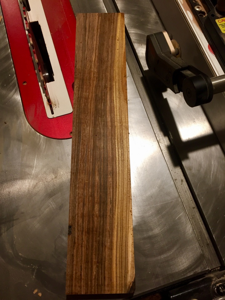

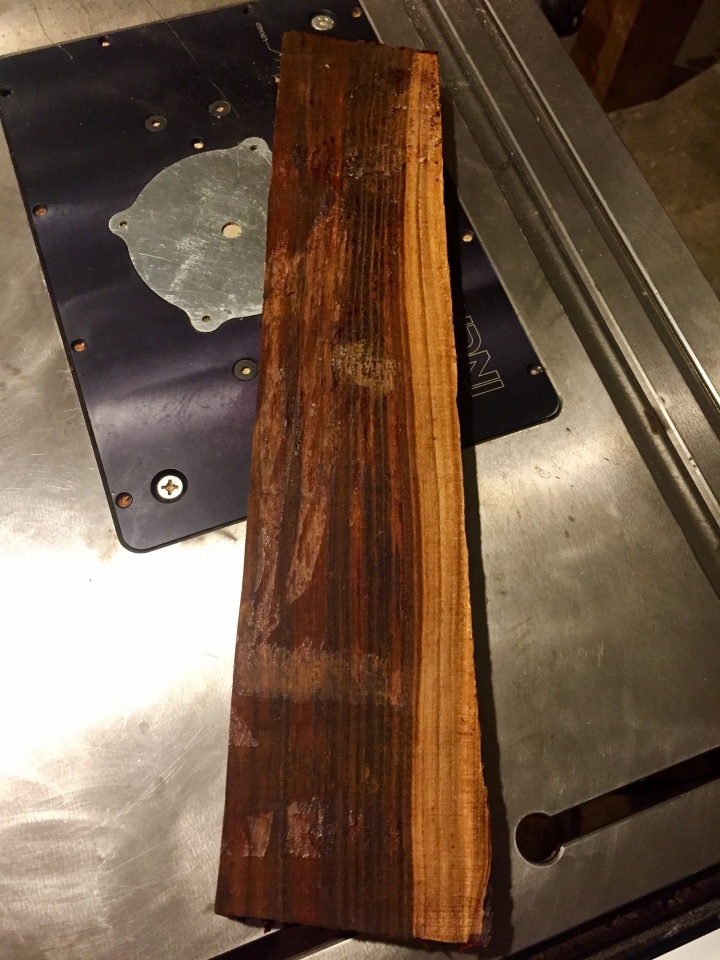

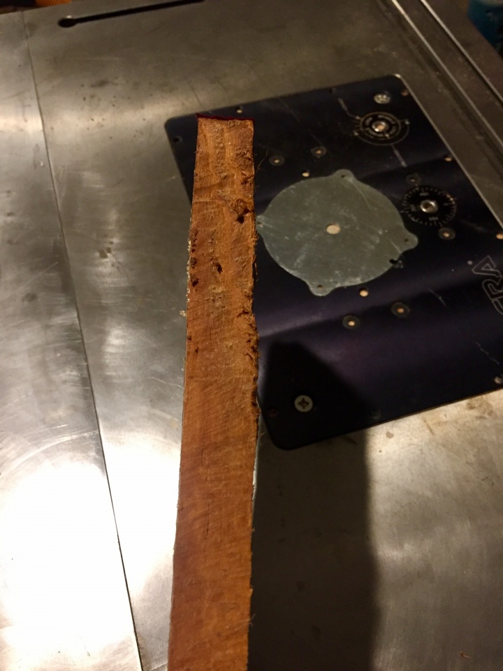

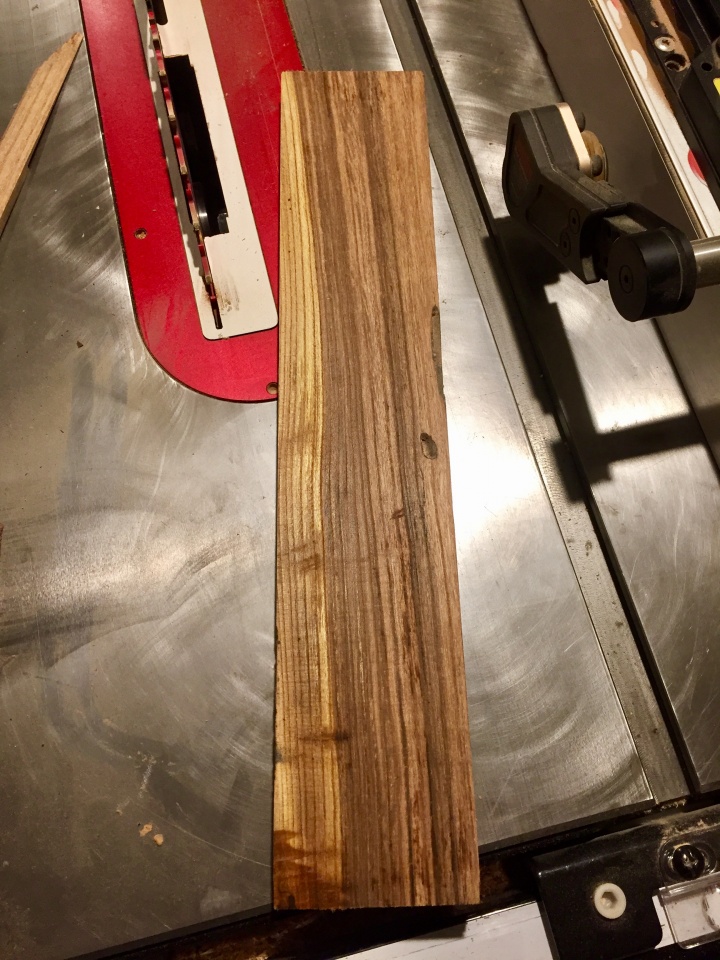

Finally got around to experimenting with planing a stabilized board. I baked 3 boards while clamped to minimize any distortion and then let them cool while still in the clamps. In short, milling was no problem-there was no funny behavior of the wood or performance of the machines. I didn't notice much if any difference running them thru the jointer, planer (at 1/32" passes), or table saw. It stands to reason that doing this would dull the blades quicker though. My tools have spiral cutter heads with carbide inserts so dulling wouldn't be as much of an issue but it's not something I will be doing a lot of anyway but is good to know that this is a possibility for the kind of work I do.
Some before and after pics of one of the boards: I didnt plane this one down to remove every last imperfection as this was mostly an exeriment.

I dont know why the stabilizing solution would have a negative reaction on your cutting tools? As long as there isnt any grit mixed in the equation, especially if everything you have is carbide tipped.
As far those two boards that have splits. Use a butterfly inlay joint across the split to keep it from splitting anymore. Complete your planing before setting the inlay.
i figured the cured cactus juice would be harder or more dense than the wood and therefore wear the cutters quicker. i guess that's not necessarily true and it may be that it's actually less wear on the cutting surfaces. the chips ccoming out of the machines seemed the same as unstabilized wood but there did seem to be more sawdust generated than usual.
concerning the split (thats the same board in all the pics) i was thinking the cactus juice would prevent more splitting. in any case, i'd fill the voids with clear epoxy.
