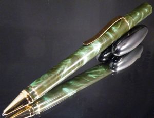

I used "Majestic Green Mica" from Coastal Scents for this blank ,
