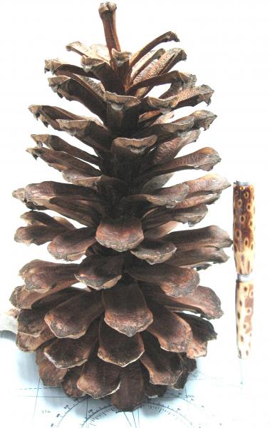

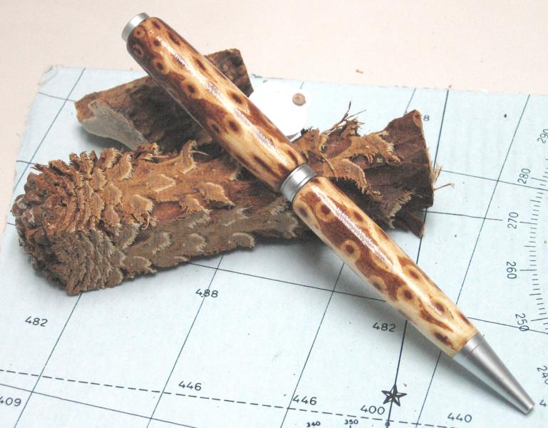

My method is simple. I take a cone like below cut the tabs off down to the core of the cone. Soak with CA, drill hole, soak inside the hole with CA redrill the hole make a pen. You will need to apply more CA as you turn.
There is really no need to cast these as you can see. btw the second shot is after the tabs are cut off.
Beautiful pen and thanks for your method.
