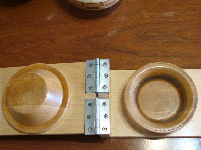

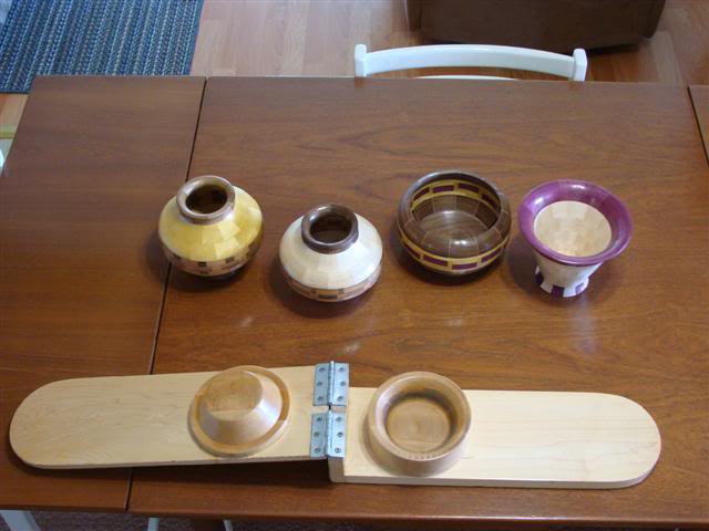

Has anyone here ever made a pie crust press like shown ?
If so I would like to pick your brains on a few aspects of it.

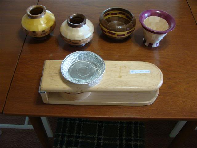

A couple members of a church brought it here today ask if I could make one for them. The one shown was originally made for 4" pies and they want a six inch one like for the aluminum pie plate size shown. .
The only reason my feeble attempts at segmentation are in the picture is that I was showing them to the people that brought the press here and they were on kitchen the table at the same time .

Thanks for your replies and here are my latest thoughts on this project .
I was having second thoughts about doing this one but will probably give it a try anyway as soon as I can get back in the shop from my hand injury. ..
It looked easy enough until I started thinking about it having to have an even thickness of crust all around. The top cone shaped piece would have to be dead center into the bottom piece and the space at the bottom would also have to allow for the same thickness of crust as the sides.
A slight misalignment front or back or sideways when securing the hinges could cause a thin crust on one side and thick on the other . Same for back and front.
I am always up to a challenge and seeing as this is going to be a no charge undertaking for a church apart from the hardwood and supplies (no labor charge ) I am going to have to find out the thickness that is required for the crust. I also need to know if the crust needs to come over the top edge or just stop at the top ..
I am thinking if I turn the piece first that the aluminum pie plate fits into and then hot glue or double sided tape fasten some shims on the inside edges and the bottom for the required thickness of the pie crust , then I could start turning the inside cone part until it fit snugly against the shims . If all goes well to that point , it would be just a case of very accurate alignment of hinges on the top and bottom boards.
BTW , those boards look like they are long enough to provide the needed leverage but they are not. Just under where the aluminum pie plate is sitting the wood shows where a hydraulic press comes down and presses the dough out. The handles are just a means of sliding the assembly in under the press.
Hey William, I don't know if you are interested in changing the design, but a pin and hole up in the front would make the alignment of the hinges and the amount of play that works its way into them over time a lot less critical. If you tapered the end of the dowel so that it is smaller than the hole to start, but fits side to side pretty precisely the last half inch or so would take the strain off the hinges and keep things from sliding around when put under the press.
Just a thought :)
